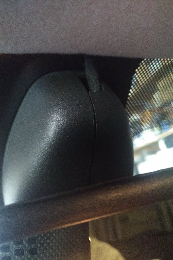

Use something, maybe a flat blade screwdriver or nail file to pry the plastic halves apart. If your cover is per the jpg, just start at the top where the wires go in.
In my case, they almost fell apart when I started; in fact I wondered why they had not seperated going over a bump etc.
I was able to get the casing removed and discovered that the sensor was unplugged! Thanks again for the help!
Hopefully that resolves the problem but one wonders if someone unplugged the sensor hoping to solve a problem.
Usually the sensor comes unglued from the glass, but it does not normally unplug itself.
I am hoping that at some time a new factory windscreen was installed and the fixer forgot to plug the sensor back in, and that now, all is good.
Please keep us updated.
Yep! That was the issue! I plugged the sensor back in and now it works perfectly
