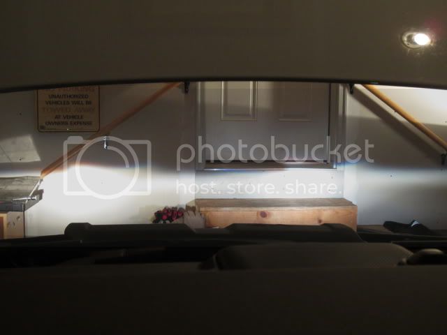

Here is a before shot.
Stock bulbs.

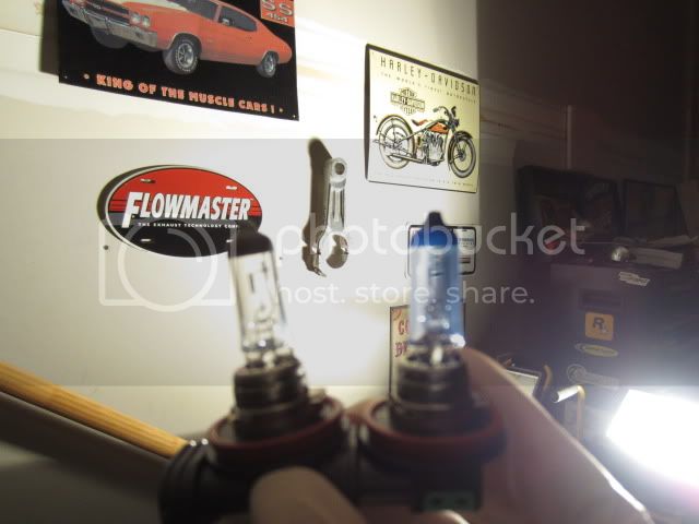

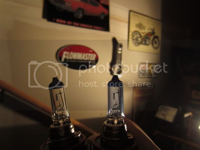

Stock on the left, Phillips on the right.

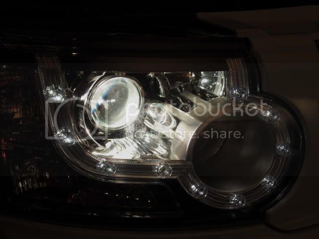

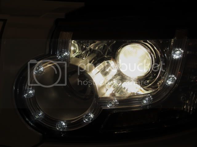

Stock bulb still in on the left. Phillips installed on the right.
Stock bulb. Notice the color difference between it and the LED's.
Phillips bulb installed.

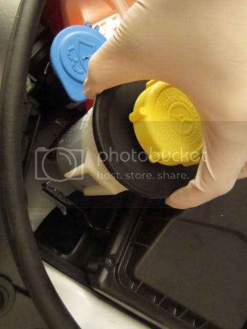

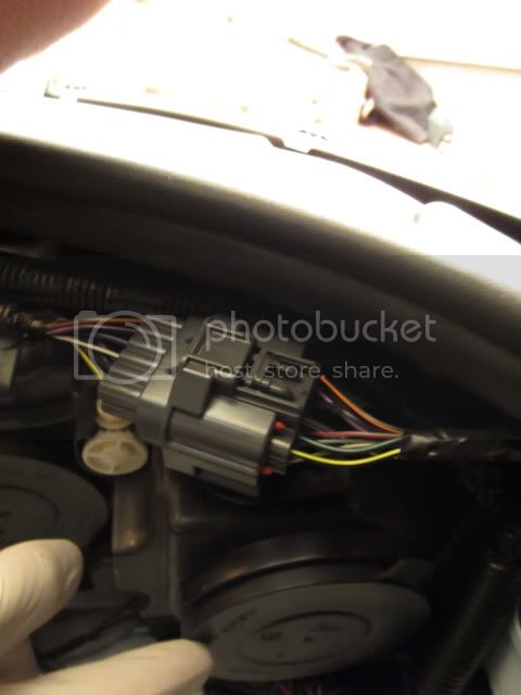

I just removed the sealer cap on both sides.
overblown
Nov 13, 2011
108
Have to move this reservoir out of the way to have room for my hands on the driver side. It just slides straight up.

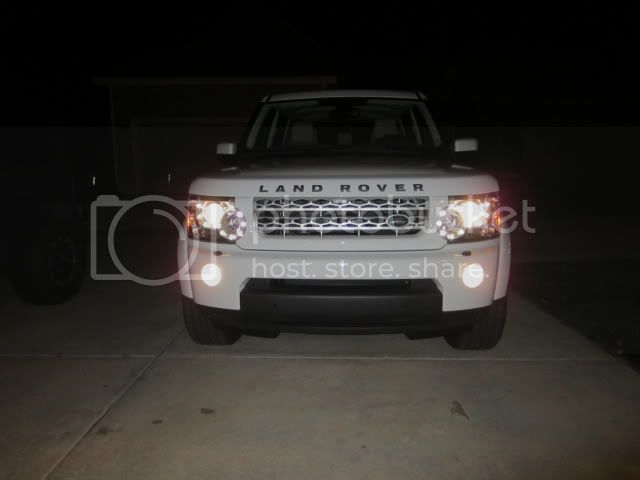

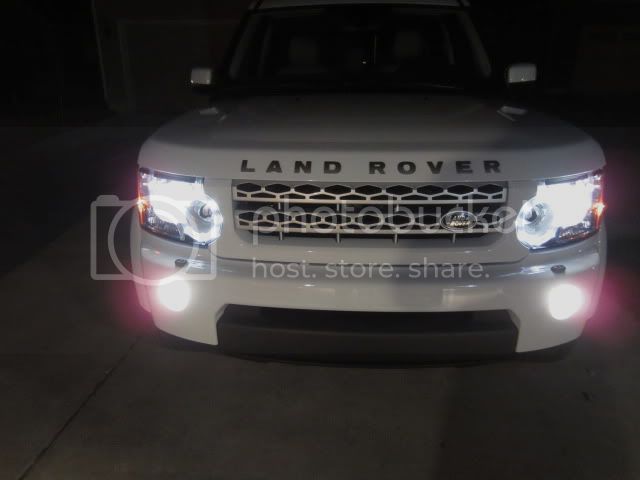

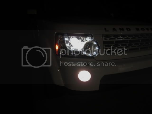

Both lights installed.
Looks like fogs will be next! Doesn't look bad in person though. My camera really captures the difference more than the eye does but that's not to say its not noticeable.
Overall, for 5 minutes worth of work and 30 something bucks I think it was a very worthwhile upgrade! I hope this helps some of you.
