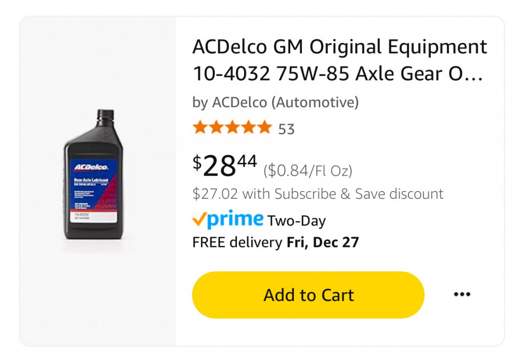

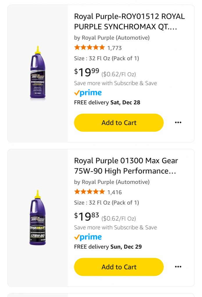

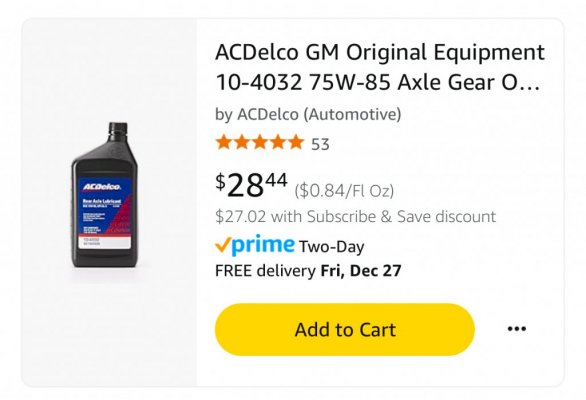

I use these Royal Purples for the front diff and xfer case, and the AC Delco fluid for the HD rear diff

I used Royal purple for diffs (non hd) and the synchromax in the transfer with no ill effects. I would have supported our local deal but $80CDN for 1L of transfer case fluid is beyond stupid.

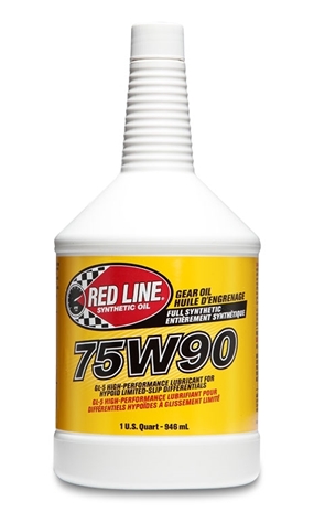

I used Redline when I changed my diff fluids.
