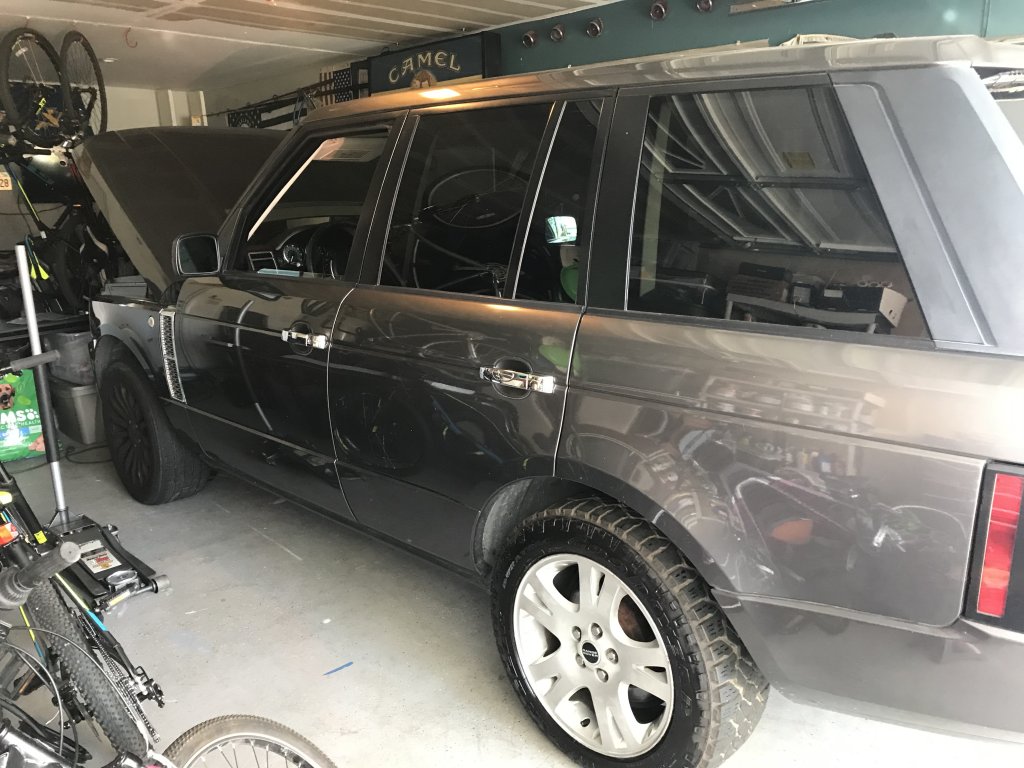

I’m having problems passing smog in California due to oxygen sensors incomplete or not ready. I replaced the 2 downstream already and will replace the 2 upstream next. I also replaced starter, alternator, battery, fuel pump and filter, water pump and a lot of coolant hoses. I’m not sure if the 2 upstream will fix the problem, but hope so. Also I hear a hissing sound which sounds like it’s coming from near the EGR passenger side. I also replaced the PCV valve and tried spraying starter fluid to find a leak but no luck so far. Any other suggestions?

Replaced the 2 upstream oxygen sensors but still shows O2 sensors monitors not ready. All other emissions are ready. Could it still be egr valve if it shows ready egr system ready. I should note I used an OBD II scanner and it doesn’t show any other engine codes. I’m fairly new to all of this and have been replacing quite a few parts and hope to pass smog soon
Thanks any help would be appreciated.
