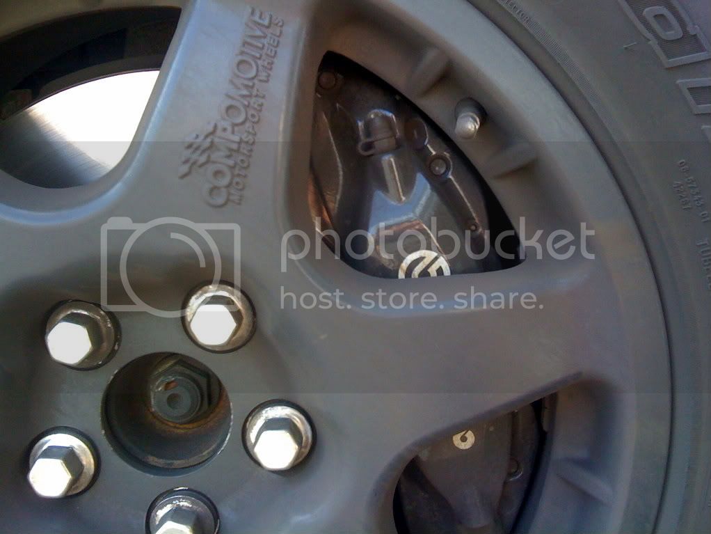

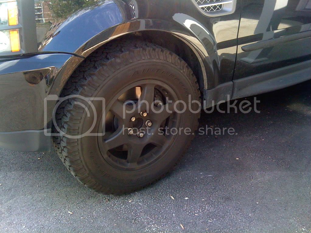

2009 LR3 and RRS front disc brakes diameter: 13.3". LR4 and 2010 RRS diameter: 14.2". There's no way an extra inch of disc could fit inside my OEM 18" wheels, unless they managed to design a miraculous low profile caliper around them.
A UK alloy wheels manufacturer, Compomotive, makes an 18" rim that is able to clear the front Brembo discs and calipers of the outgoing RRS S/C (also 14.2" in diameter...) It was originally designed for the Bowler Nemesis but a few RRS S/C owners suffessfully fitted them by simply flipping around the harmonic blocks on the Brembo calipers. It would be cool if those rims also fitted the new 2010 brakes, as they also look pretty cool and very tough. Here is a couple of photos of them on a S/C RRS:
