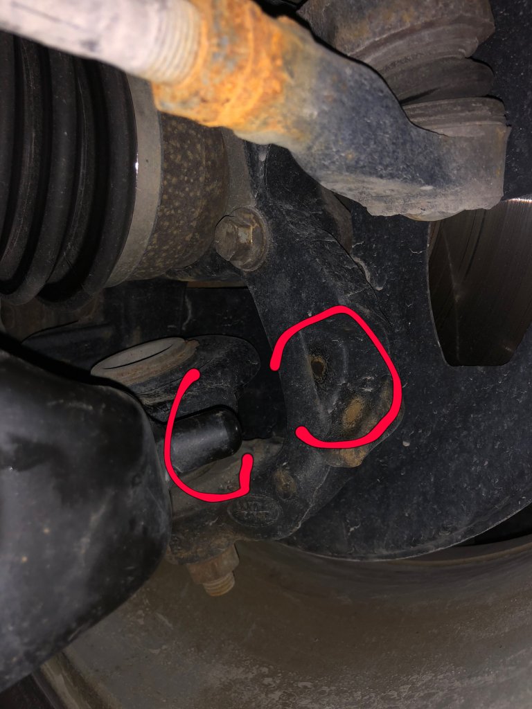

Did you just put the grease between the brake dust cover and the arm?
View attachment 8583 I had the EXACT same noise only would happen while backing out of my driveway. I brushed a little anti-seize on the 2 spots and haven’t had a issue ( it’s been probably 10,000 miles and quite a bit of mud sand and flooded roads) sorry for the crappy pictures. Hope this helps
I have the exact same problem...Did you just put the grease on those two parts to eliminate rubbing between each other when make a tight turn?Thanks!

Quick update for my LR4. Same problem as shown in the red circle spots! I will try to put some grease later to see the result!
Strangely enough, with the onset of winter the scraping noise stopped on its own. I’ve not had the opportunity to get under and apply the grease yet (plus it’s too cold to work on it).
Hopefully you’re able to resolve the issue and update the thread.
