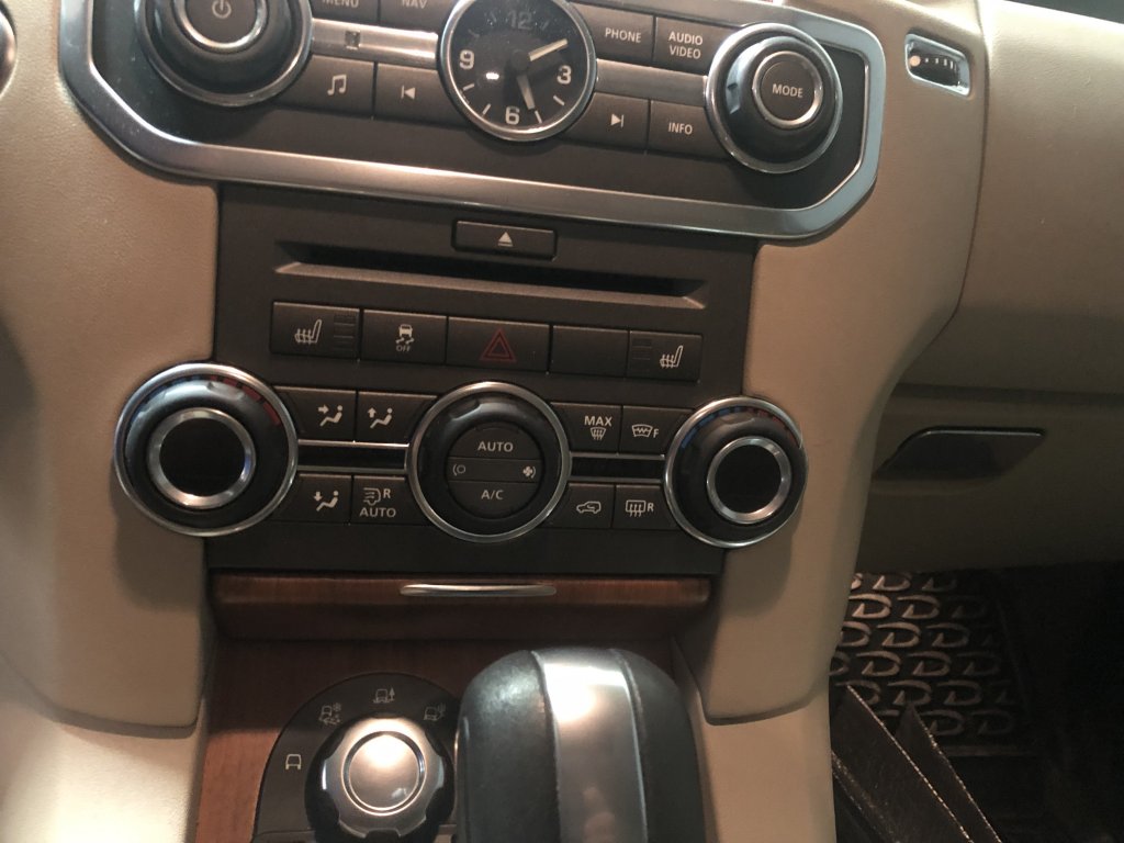

Cthehentz
Feb 24, 2019
166
65
Las Vegas
No parking sensor button, just a plastic blank cover. Now I do have the factory tow package but, I have not towed with this LR yet.
gsxr
May 8, 2017
806
415
Big Sky Country
Thanks for the photo! That is WEIRD. I wonder if the button was phased out after a certain model year, or if it's tied to a particular option/package?
