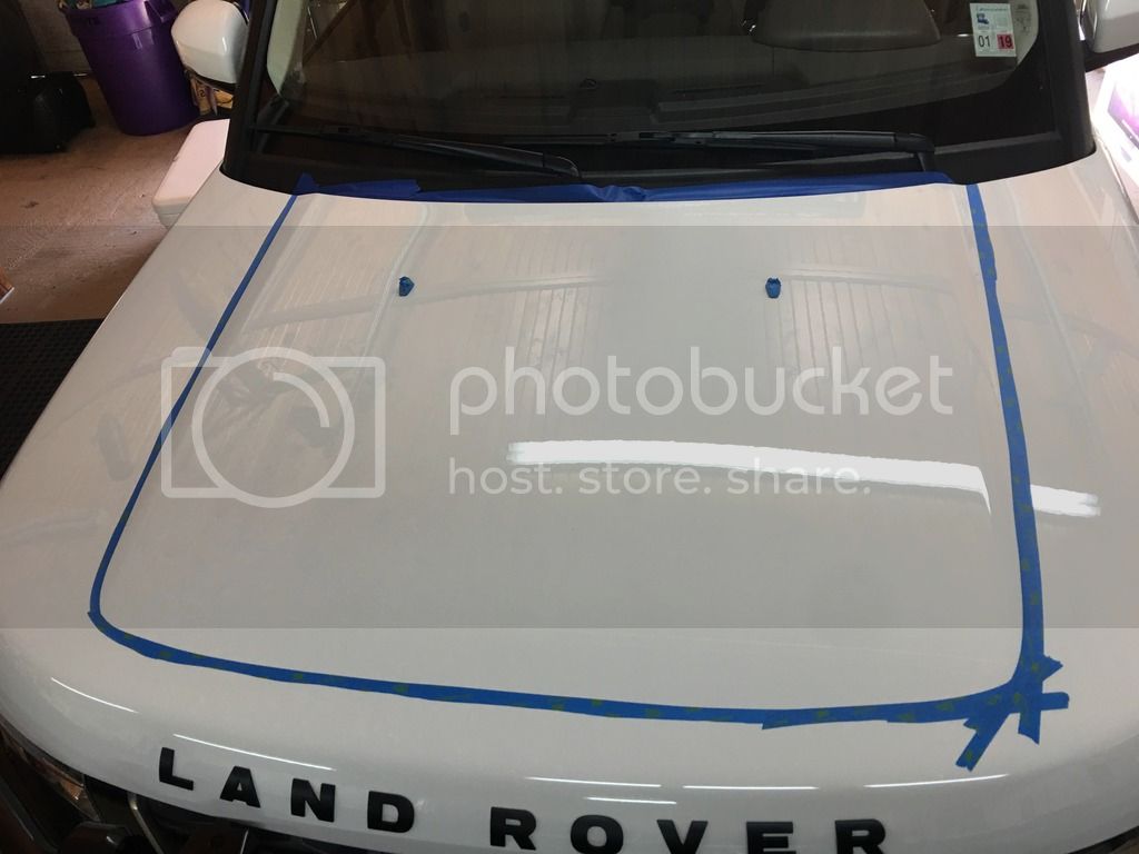

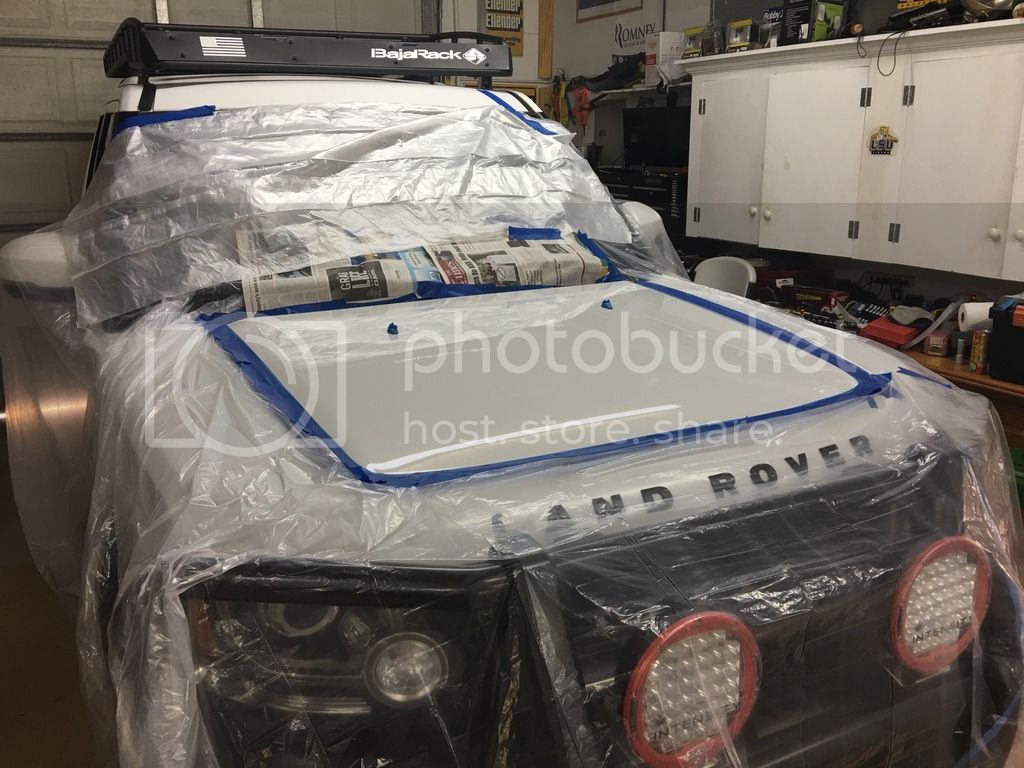

One of the items I wanted to do was blackout of the raised portion of the hood. There are a few people out there that have created these; however, they do not cover the sides of the raised portion on the hood. I asked if they would change this and got a why would you do this as we've never had this request before? Back to the drawing board on doing this on my own. As I was doing the plasti-dip I thought I could give this a go for the hood as well which leads me to today and my Saturday afternoon project.

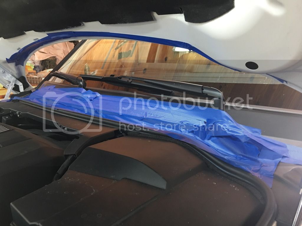

Hard part for this is masking off the lines and getting a good curve towards the front of the hood. For me I took normal blue tape and cut it in half to be able to bend the tape easier on the curves as you see below:

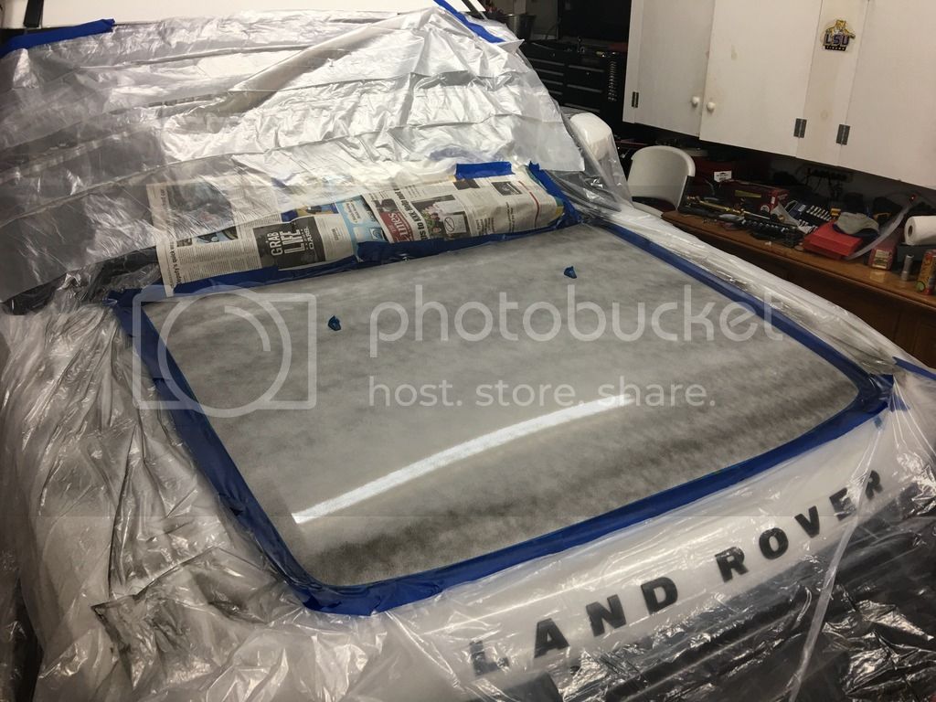

Once this was done I then began to mask off the truck. Key is to open the hood and mask underneath the the hood near the edges and along the engine bay near the wipers to give you a good clean mask.
Here's the truck fully masked off using drop cloth and newspaper ready for the first coat.

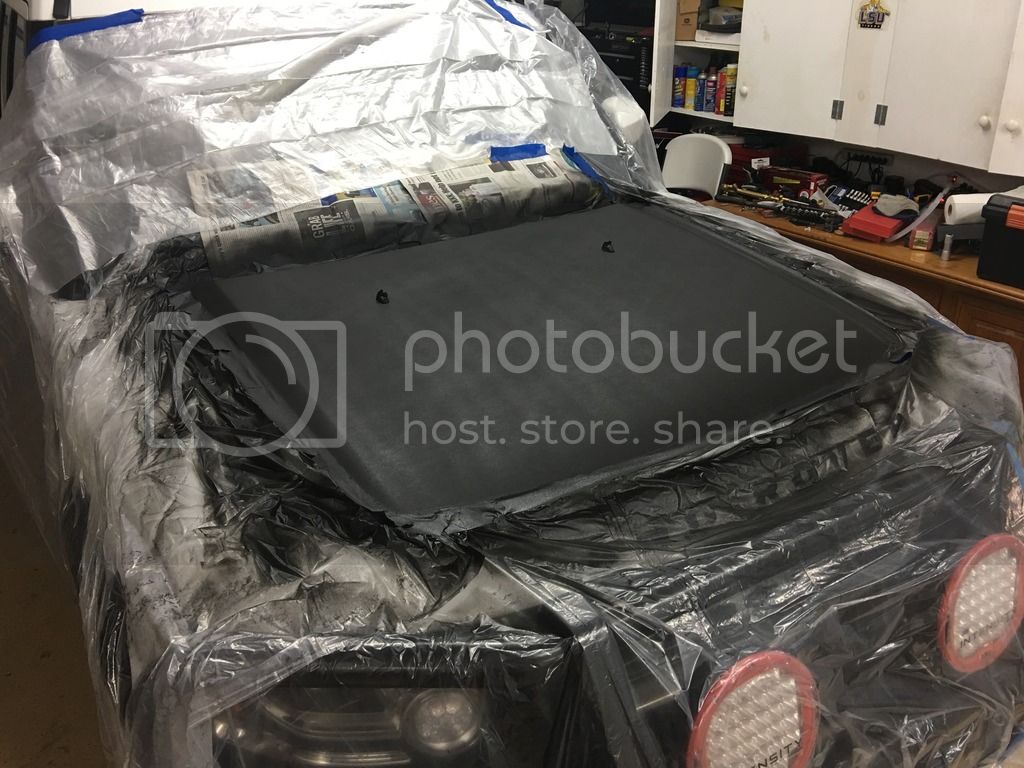

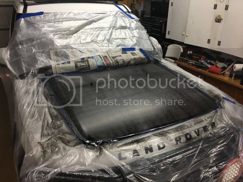

First coat applied. Key is not to overdue it on the first coat.
Shot of the 3rd coat.
Shot of the 6th coat.

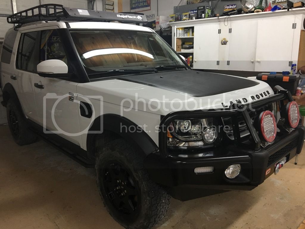

And finished product...few coats later.
In summary it's still a little early to tell as it needs to properly dry. It was hard to get a good even coat on such a large surface. I was standing on a ice chest on the front trying to cover the entire area but also standing on the sides to change up the direction of the strokes. I'm just glad I was able to get a good clean break on the lines when I removed all the tape. Overall though really pleased with the look and anxious to see how it holds up.
I'll let it cure for a bit then take it out for some better photos to share.

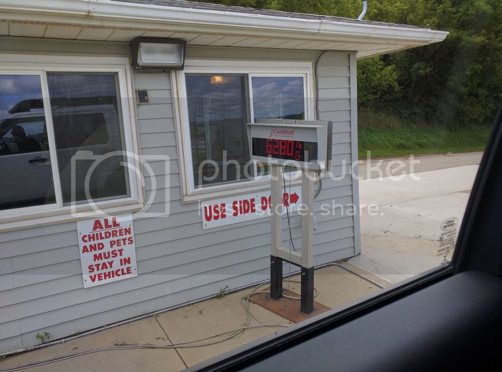

This is my current setup leaving the dump... empty cargo and just myself in the LR4.
