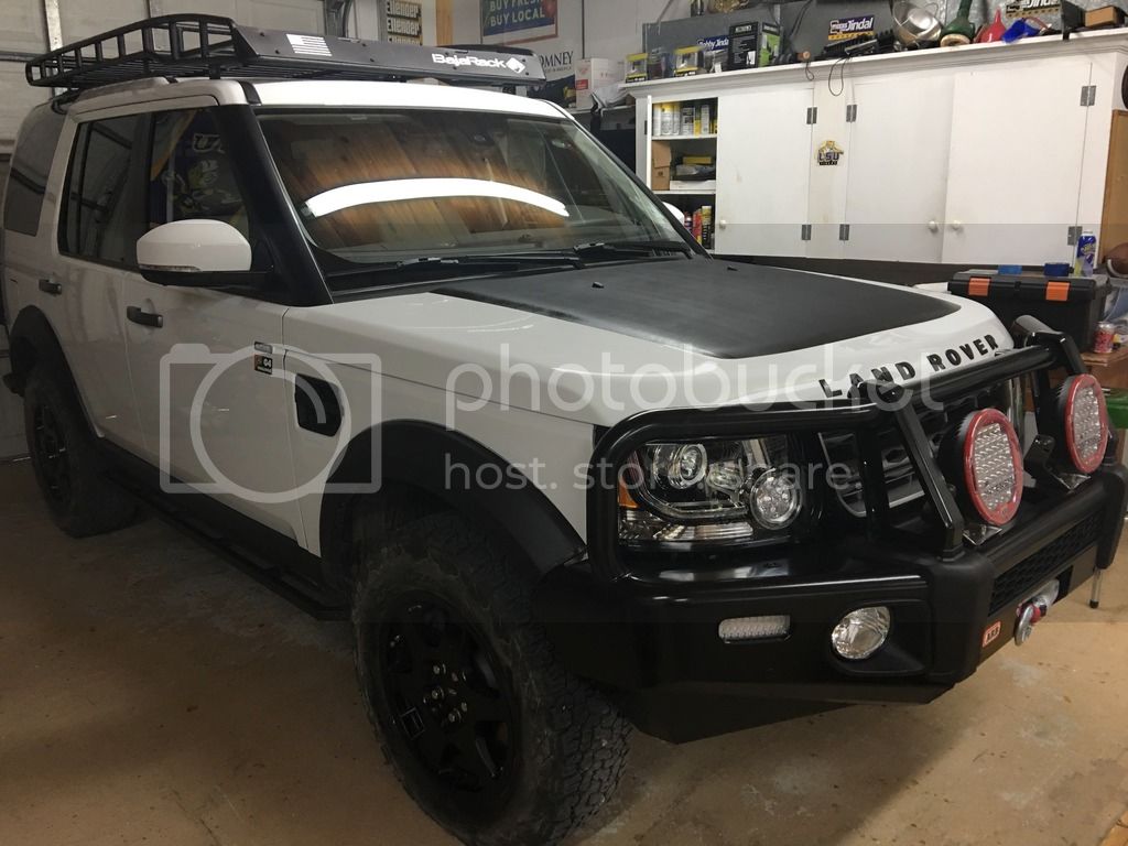

And finished product...few coats later.
That looks awesome!!! I can't wait to try it on mine depending on how yours turns out. HAHA! :)

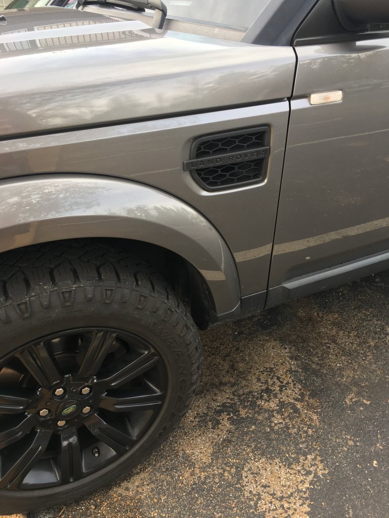

ok ok ok....
how did you get the side vents off without breaking them? I had multiple people tell me trying to pull them out is a fool's errand, and that they'll just break...
i ask because i need to redo mine, as i didn't understand the zen of Plastidip, and taking them out to redo them would be much easier.
and also - WOW. what a sled! I'm going to show my wife this post so she understands the long-term goal!
Thanks a ton!

They are just a pain to remove, that's all. They feel like they are going to break and you can end up with bloody fingers, but in the end they will come out. Using an old credit card to get some leverage might help. There was a thread here somewhere with this exact topic.

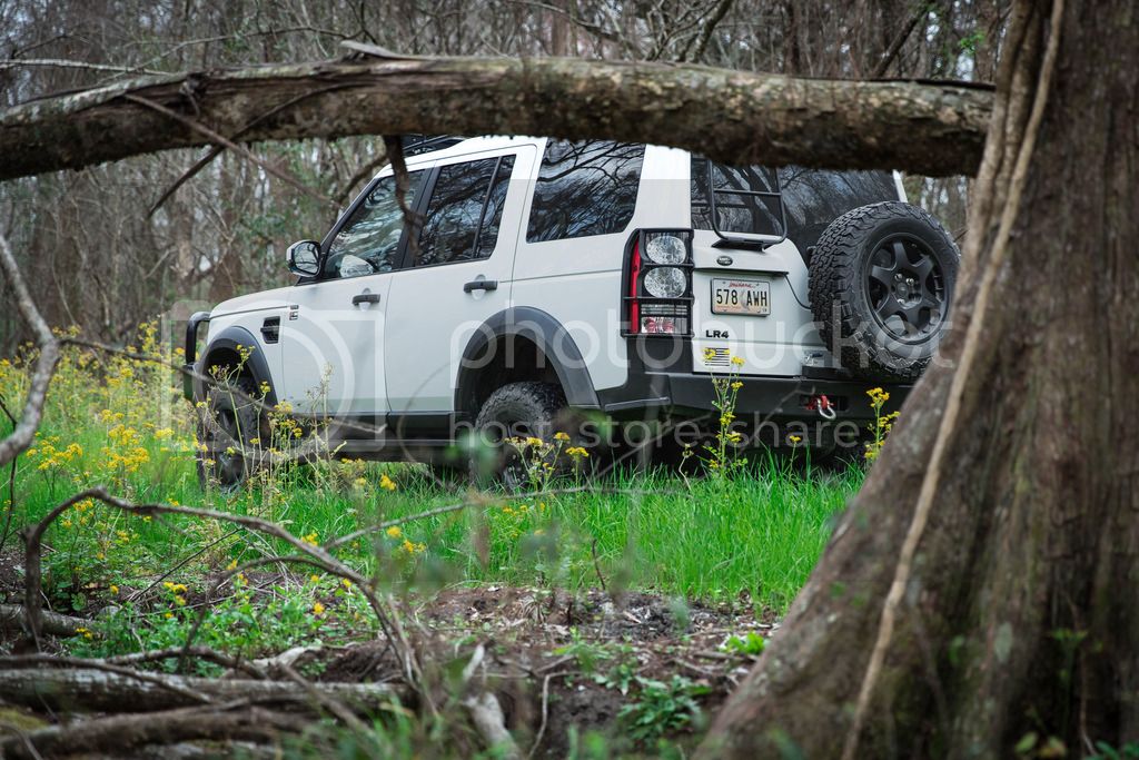

How did you get the front runner ladder on without a gap on the outside edge? Did you bend it? The fit on those things is terrible.
Head over to the accessories section under LR4's. I recently installed and uploaded a picture of the Front Runner ladder. I haven't noticed a gap. My ladder included a plate that bolts to the top hinge. Without that I could see a gap.

Here's a video I found online showing you how to remove the vents.
As you can see it requires a bit of force and like someone said some bruising along the way. LR4 definitely doesn't have a shortage of plastic bits that are hard to remove without being able to reinstall them but the vents are definitely able to come off. Good luck!!

@ColoradoDisco4 i just dipped mine last week. I used. A flat head screw driver and went in from behind the grill. Open the hood and on both sides near the hood hinges is a small opening. Shine a light down and you can see the tabs. Mash those down and pull out.
