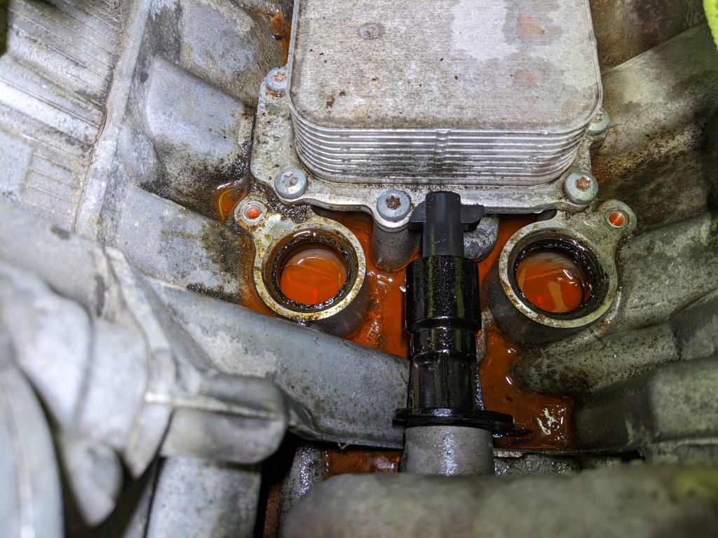

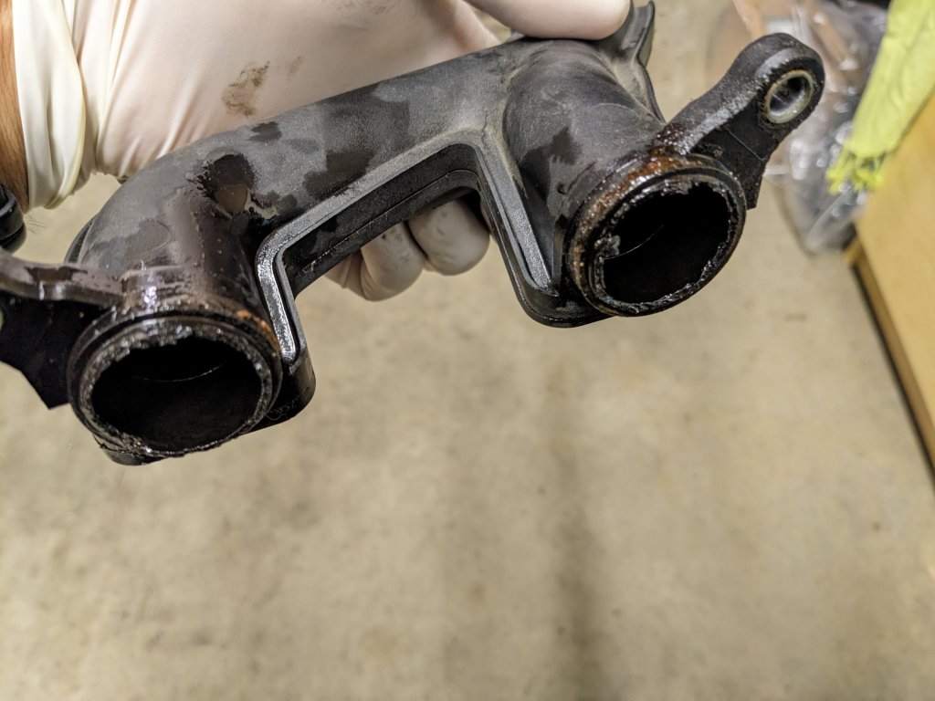

Here's an update on my experience...I got a 2015 65k hse lux a year ago. Did my research, knew coolant pipe is a must. For various reasons, project was pushed, but was finally ready to do the project 3 months ago. Realized parts are backordered. I kept an eye on the back ordered parts, while doing my hw on the forums and watching @txfromwi detailed video.
Also, fortunately, I kept checking coolant level. Last month coolant level dropped. I used UV lights to look for it, but couldn't find it. Took the car to local dealer just to get their opinion and quote. They said not to worry, coolant levels drop through evaporation - asked to just top it off. Parts were still hard to find, so regretfully, I topped off coolant, and checked coolant level like crazy.
Two weeks ago, coolant level dropped a lot. Immediately stopped driving and started shopping for parts. Asked for quote and dealer said rear manifold still missing till end of June. Won't even give me a quote (seemed not interested).
So I bought all parts from local dealer online (cheaper than Rover parts). Luckily, lucky 8 had 1 rear manifold, (at almost 200% than usual, talk about price gouging), so just grabbed it.
Started the project and once I got down to y-pipe, yikes. Near complete failure (see pics below). Waiting on coupler to finish the reinstallation... Hopefully I caught it just in time and no lasting damage.

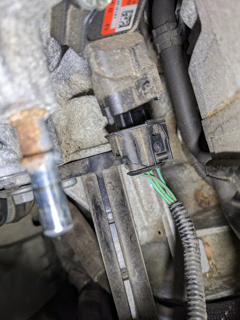

Hey Dan @txfromwi and @Turismo Kid , I took this pic just to share with you (see below). Thanks to Dan's through explanation, I was able to detach in less than 5 mins
But don't worry, "there was much sadness" for me too, on various other items. In particular, everything to do with rear manifold. How the heck do you all get back there? I always seem to be resting on my gut and hurting bad to try and get anything done back there.
What coupler? The aluminum piece between the two front crossover pieces? The new pipe design doesn’t use a coupler in that spot - just joins directly together. In any case, I’ve already seen reports of these later pipe designs degrading in the same spot. I think I’ll be putting aluminum in the next time around now that some third parties are making them.
That’s about it…laying right across the top of the engine, and sometimes knees on the radiator and ass in the air. Nothing fun about that rear harness.
