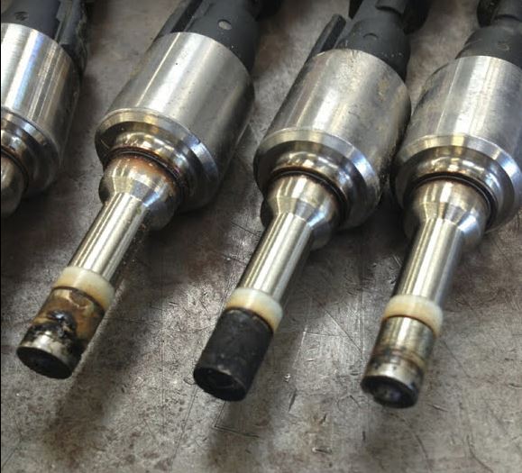

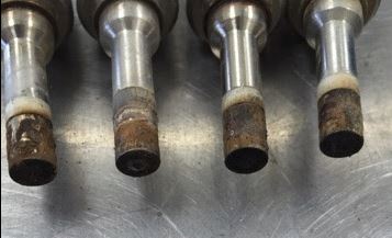

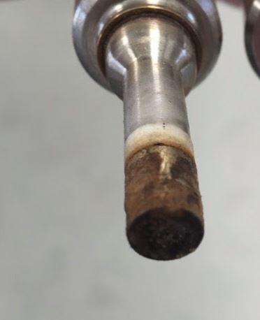

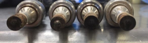

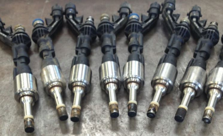

here were shots from an 11 that has had injectors fail twice ~45k each time. always running 91 (CA)
1-3 were from 2017 ~90k Miles / 4-5 were from 2015 ~45k Miles
My 12 LR4 however haven't started acting like this 11 RRS was - going into limp mode and barely running.
Same engine and injectors though in both engines.

Damn. Rough idle on these or anything noticeable?
