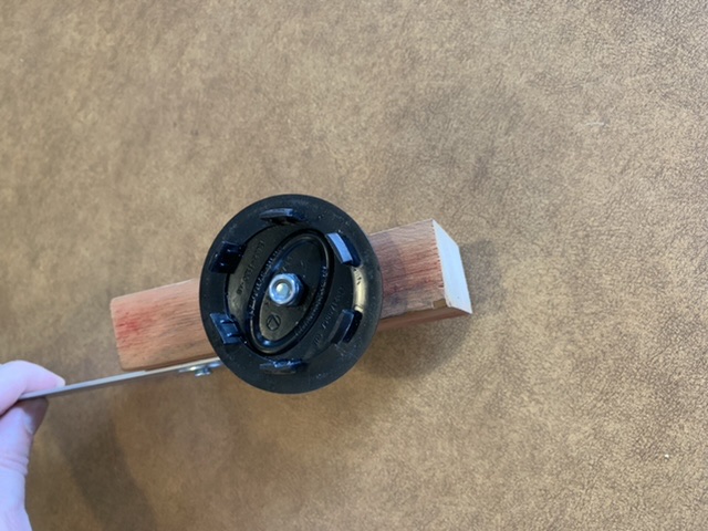

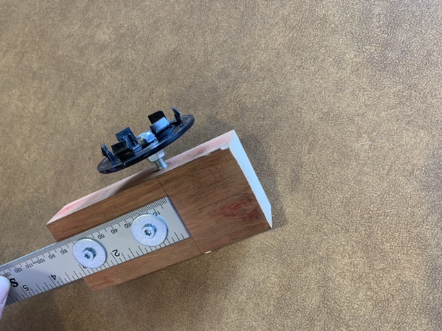

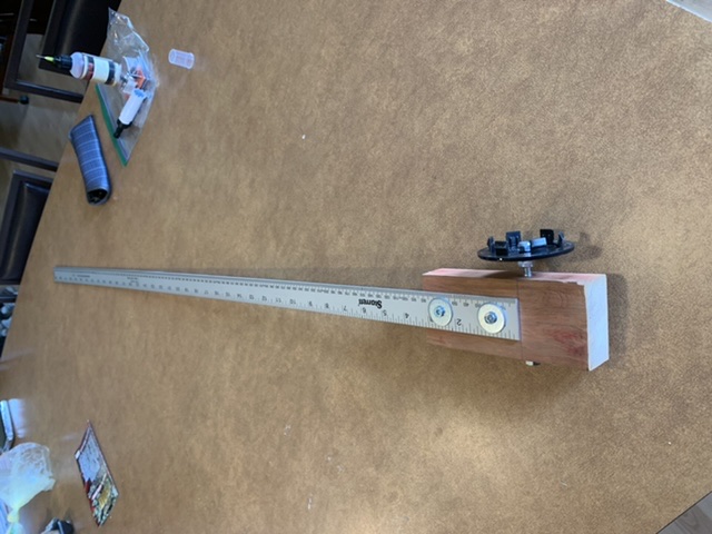

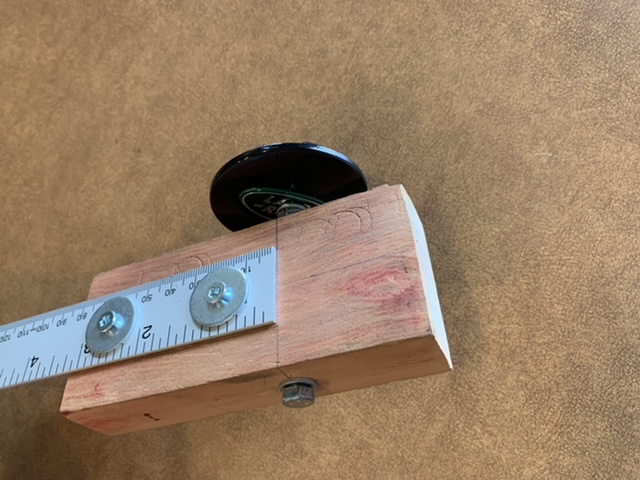

The meter stick is from Amazon. I think it was around $12. The center cap was from eBay. There’s a circular molding mark on the backside that’s dead center. Remember to orient the mm side to the outside face of the center cap
