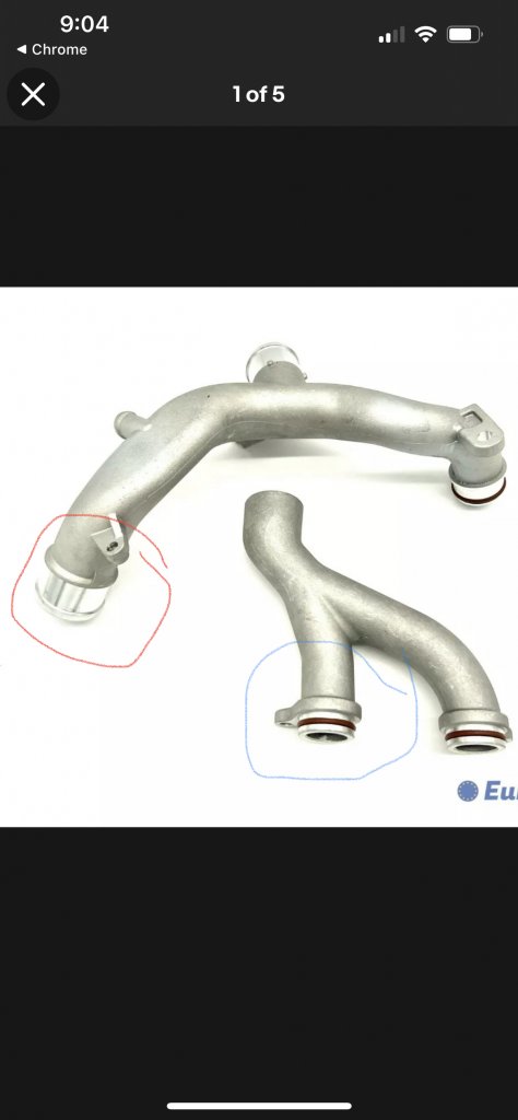

Also just thinking, a cheaper/easier method to me would be an aluminum adapter that goes into the block but accepts a molded coolant hose. Then have aluminum adapters to connect to the current hoses. This method would allow access (with an extension) to a banjo clamp at the block without removal of the SC.
Interesting idea, but I'm trying to visualize how would you mount that to the block? With either the factory piece or this piece you have three bolts holding the structure down, so it stays flat. With only one bolt per side I'd wonder if one side of each connection would tend to lift, breaking the seal of the o-ring.
In my mind it would mount just like the stock piece; the difference would be that the external part would kinda mirror the part that goes into the block. It would be a couple of more pieces, but the red part would be the exposed end of the blue parts.
Just the thought of more rubber hoses sounds cheaper than all aluminum and more reliable than plastic. It may would look “sloppier” with multiple unions, but couldn’t really look worse than the other coolant sections by the thermostat that has a bunch in a short space. I’m no engineer, just thinking out loud; I’m also not good with photoshop or any design software to put my idea in a visual format….

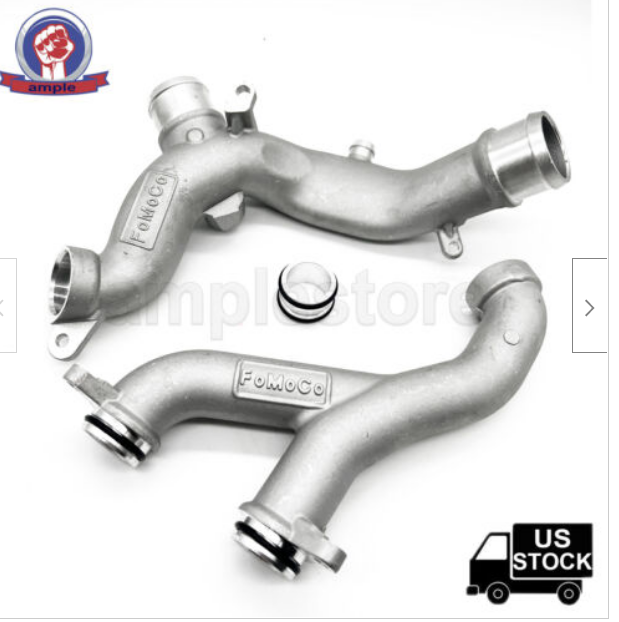

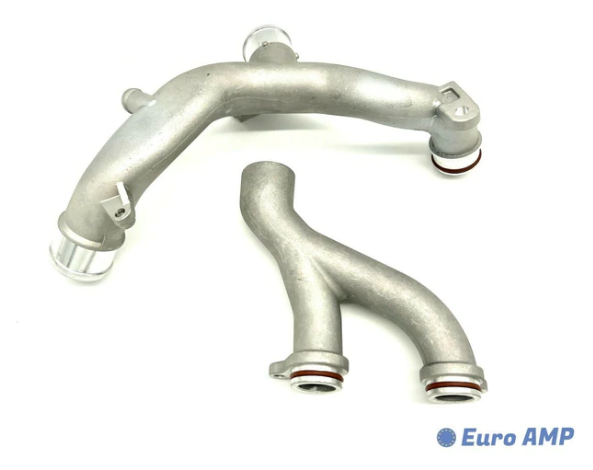

I spent some time looking at these and I actually see two different versions, from different sellers on E-Bay.
One version looks to be an exact match for the new style parts I have in my garage.
The upper fits down into the lower, with one o-ring, there are two piece parts.
These parts, if the photos are accurate, have no identifiers cast into them.
Source EuroAMP, Houston, TX
The other version has three piece parts. The upper and lower butt up against each other and inside there is a nip*ple with 2 o-rings. Sealing at the upper and lower.
These parts, if the photos are accurate, are cast and they say Ford (FoMoCo)
Source several vendors on E-Bay.
IF I do this, I am leaning toward the Ford parts with the nip*ple inside and the two o-rings.

The second pic you have shows the "Y" pipe having more of a bend to it, almost ending up perpendicular instead of parallel.

It seems odd to me that they made both considering JLR updated the 3 piece design to a 2 piece. If it were me I’d go 2 piece; that’s what my new pipes are and that’s 1 less o-ring to fail or pinch on install.
