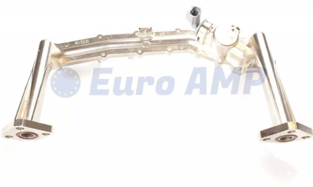

Well, I drove over to EuroAMP and I did not return with the parts.
I looked at two sets of top/bottom front crossovers for the 2016.
This is my opinion...
I may be way too picky, but I was not pleased with the quality of the casting or the finish on the mating surfaces.
The female interior surfaces/transitions were sharp from the casting and the interior flow channels were not smooth at the transitions as they should be.
The male surfaces were sharp from the casting and chipped (sometimes badly), presumably in shipping.
It appeared to me that there were no finishing steps applied after the parts were cast.
It also appeared to me that the parts had been simply dumped loose in a box with no protection and then impacted each other during shipping, thus causing the chipping.
In my opinion if something as easy as shipping cannot be completed properly, and the castings leave sharp edges, then I lose confidence that the o-rings used are of good quality and I lose confidence that there is any quality control during manufacture.
I could have lived with the sharp edges from the casting, but I could not get past the chipped surfaces.
Would these work - sure.
But not for me...
If you go this route I would suggest purchasing o-rings of known quality.

Great notes tx. One thing I noted when I replaced mine was that the O rings had become very soft compared with new spares from LR.
The other thing that would make me pause is the type if alloy they have used. Different aluminum alloys in the presence of coolant when they start to leak past the o rings, which will happen eventually, can be very damaging indeed.
I’ve had this happen on Detroit diesel generators in the past and it’s been expensive to repair to say the least.

I spoke to Phillip at PalmBeach Rover Parts and he told me that the 3 part design in aluminum was an old Rover design that had been changed out to the new plastic 2 piece design and that when older vehicles come in they are updated to the new plastic parts. He did not have a good explanation of why, but from what he offered there did appear to be operating temperature related technical data behind the change, not just manufacturing cost concerns. He was unaware that either the 3-piece or the 2-piece designs were available in aluminum.

Here's the rear for the TDV6: Dude's promising the 5.0L by the end of the year..
