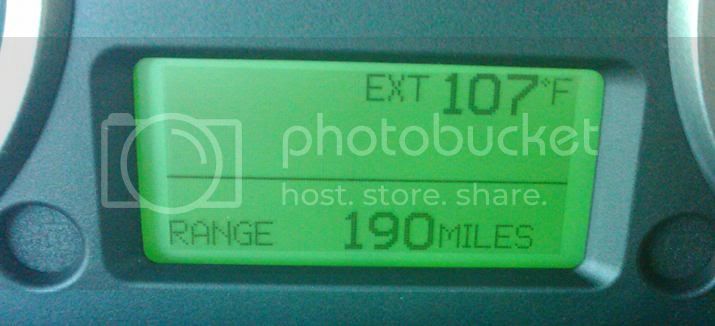

How high? My guage occasionally displays 5-10 degrees above actual outside temps on very hot days. Then the cooling fan kicks on and it settles down closer to reality.
Taken on a 98 degree day:

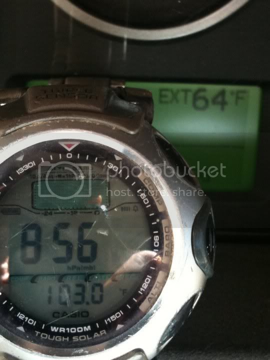

OffRoving
Oct 16, 2006
79
I was in the heat this weekend an my ambient was low. It was over 100 out but the gauge said [even after 3 hours of sitting in the sun] 64! I too would like to know where the sensor is so I can check to see if it's covered in mud or something else which could be causing this.

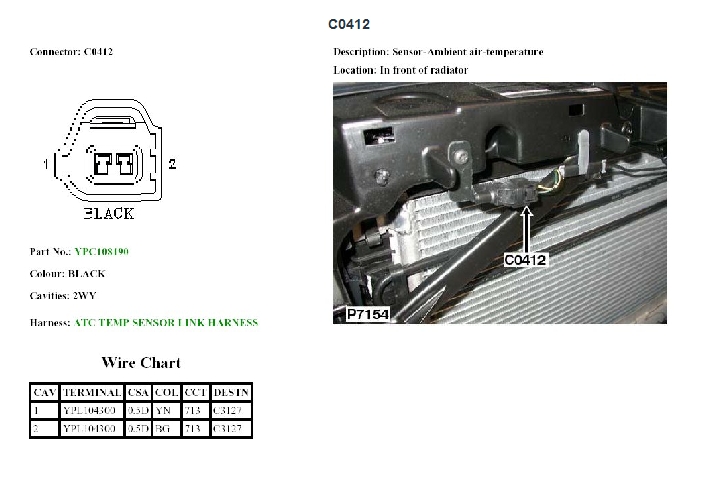

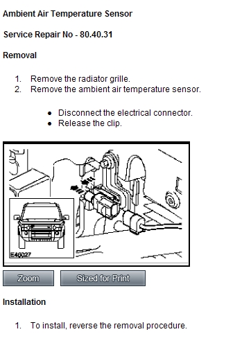

Doesn't look too difficult
ryan-in-oregon
Jul 7, 2009
538
Was worth a try but mine isn't located in that spot!!! And it is intermittently wonky!! Screw holes are empty and I don't even see the wire harness connector for it..
bscmich
Jan 6, 2010
100
Hmmm? Mine is right there. Easy to see thru the grill.
bscmich
Jan 6, 2010
100
What year is yours?
06 SE. Actually, mine isn't mounted exactly as the pic indicates. There is no bracket. The harness is attached by some ties but in the same location across the top and in front of the radiator.
