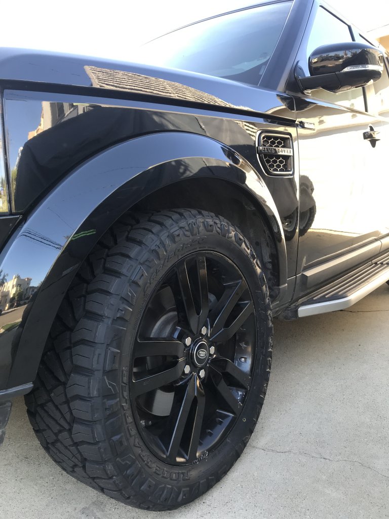

Jul 19, 2020
Redondo Beach
265/50/20 Nitto Ridge Grapplers. Not the G2’s. Same exact size just more tread and sidewall. No mods needed. No rubbing at all. Quiet on the road.
