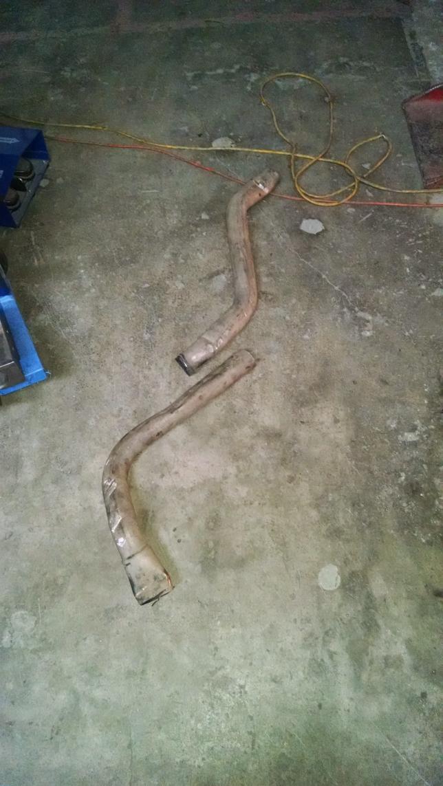

Damn can't imagine that the stock is better then the magnaflow since I bang the hell out of the stock last time I did a little rock crawling in big bear. This is what I did to the stock haha imagine a lower hanging exhaust.
