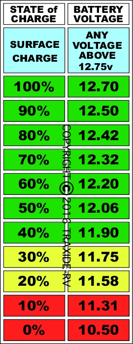

As far as your battery voltage goes, the voltage of a battery that has been sitting for at least 10 hours since the motor was last on, will give you a reasonable idea of the actual state of charge of the battery.
The chart below will give you some idea of the state of your battery.
Note, you can have a battery with a low voltage reading if you are only doing short drives.
If this is your normal use of the D3, then you are better off waiting till you have been on a long drive and then measure the battery the next morning. You will then see whether you battery is holding it’s charge or not being charged.
