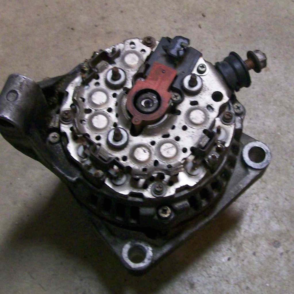

bbyer
Aug 15, 2008
895
151
Alberta
If it is just the alternator, be happy.
Yes, it is the diodes inside an alternator that tend to be what fails - and no, you cannot seem to buy parts for these alternators. (If you can, let me know where); also count the number of pulley grooves in the alternator you take out - will be either 6 or 7 - seems to vary, and you could be swapping pulleys.
If the problem is solved by installing a new alternator, be happy. There can be so many other obscure faults that make a 3 hard to start that something simple is a relief.
About 1/4 way down on the link below are some files re the alternator and more importantly, the internal regulator. I think more often than not, the problem is the internal regulator, but that means a new alternator so the point is moot.
http://www.**************/gallery/thumbnails.php?album=3801
Replace the **** with disco3 co uk and insert a period in each of the two spaces.
