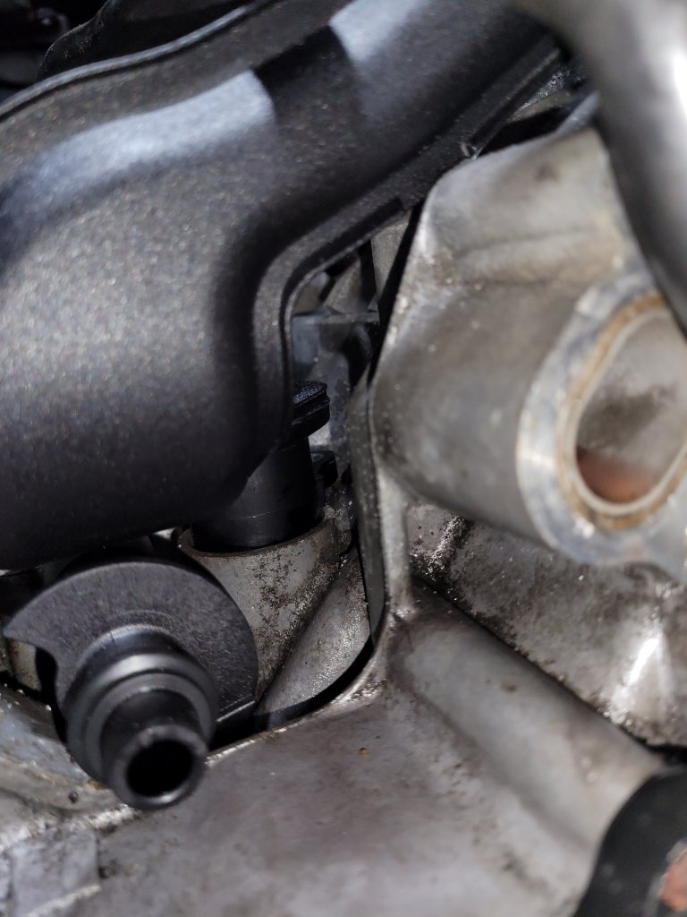

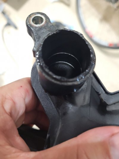

This is mine at 102k.. Disintegrated on pullout..
The second pic shows the new OE pipe properly seated- the Atlantic Briitish one never went this far down and I could see the O-rings when bolted down.. Yikes!

Every coolant crossover pipe that I’ve removed from a BMW M54 engine came apart where it enters the block requiring extensive cleaning with a sanding pad or copper brush. Even the ones that were not leaking that I replaced as PM came apart. That is not uncommon.

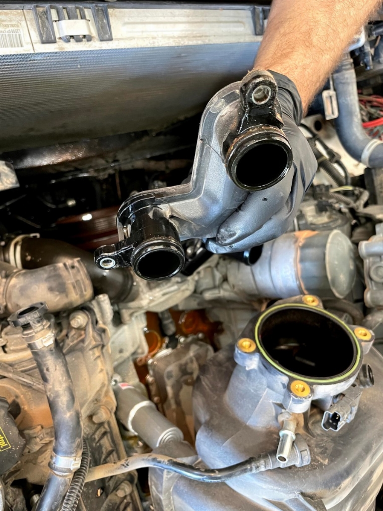

Here is mine. Original part, 0 to 80k miles. Came out in one piece and looks perfect. Then i went and put the non-OE ab one in... grrr, im hoping it is ok. We got the orings to seat all the way, just took a little work.
I think one big reason mine was fine is I don't daily this thing. It is mostly used for long trips. So it doesn't get heat cycled a lot.
