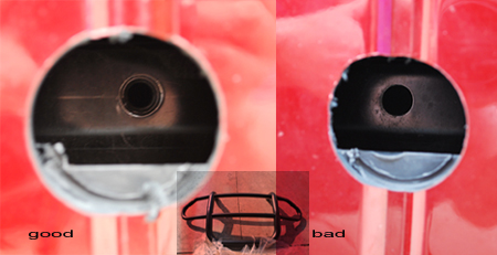

I am installing a factory brush bar and I ran into a snag. I had the long bolts that fit into these holes in place, and I was trying to fit the bottom of the brush bar in place. it wasn't really lining up very easily, so I pulled down pretty good to get it to line up. the problem was one of the nuts, (which I assume was tack welded in place behind the bumper) seems to have sheared off. I know the bolt did not shear, I guess I barely had it threaded, and the pulling down snapped the weld that holds it in place. I think I know what I have to do to get at it, but I really don't want to take the entire front end apart to get at the bumper. Does anyone have any other ideas? Thank you.

Ouch. Yeah best bet is to get behind it and try to get the nut back on the bolt. Go to the hardware store and get some spare parts that will fit on the particular nut/bolt you are using.

So you do think i need to take it completely apart?

ARGH ! I feel your pain
I didnt admit to this earlier but I severely cross threaded one of mine on installation... and I think if I ever tried to undo it, same thing would happen. Probably a bumper off fix unless you can sneak / snake a nut up there on the rear of the frame member.

Getting behind it will be the hardest part. Thats why I would just go buy a whole bag of nuts and bolts so when you drop them you can just grab another lol.
That and one of those little magnetic tool retrievers might come in handy.

i just bought 4 nuts...I hope thats enough. if it isn't you will probably find a brush bar for sale real soon in the classified section!!!!!:mad:

I had the same thing happen to me on one side. I got this quick forming/drying steel putty from home depot that I mixed together and put on the end of the bolt going into the bumper. Held it in place for a minute or two and it's now permanently bonded to the steel bumper. About a year later and I still feel confident about jumping on the brush bar.

Dantheman1,I bought and am going to try JB Weld to do the same thing to the nut. It sounds pretty similar to what you used, and I am hoping for the same results. also, I seem to think I can reach my hand in there from below. I have removed a few plastic parts underneath and if I pull out one last plastic piece, I can fit my hand behind. It's really tight, but I think I will get it with out removing all of the plastic covers that enclose the bumper.
