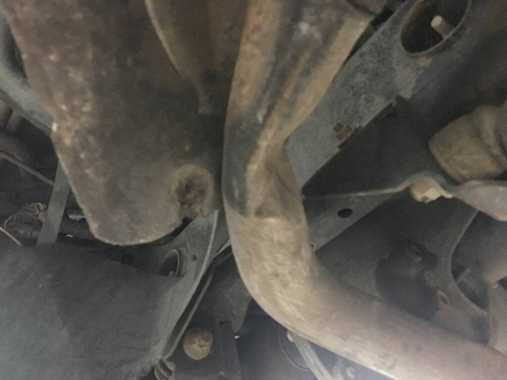

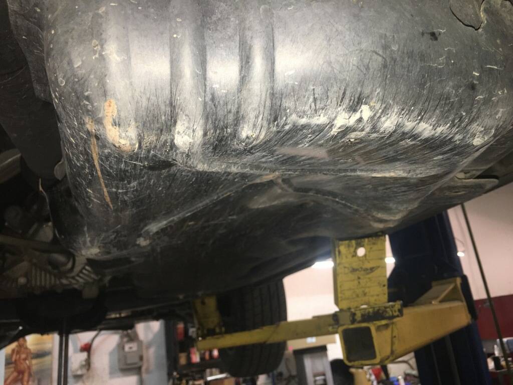

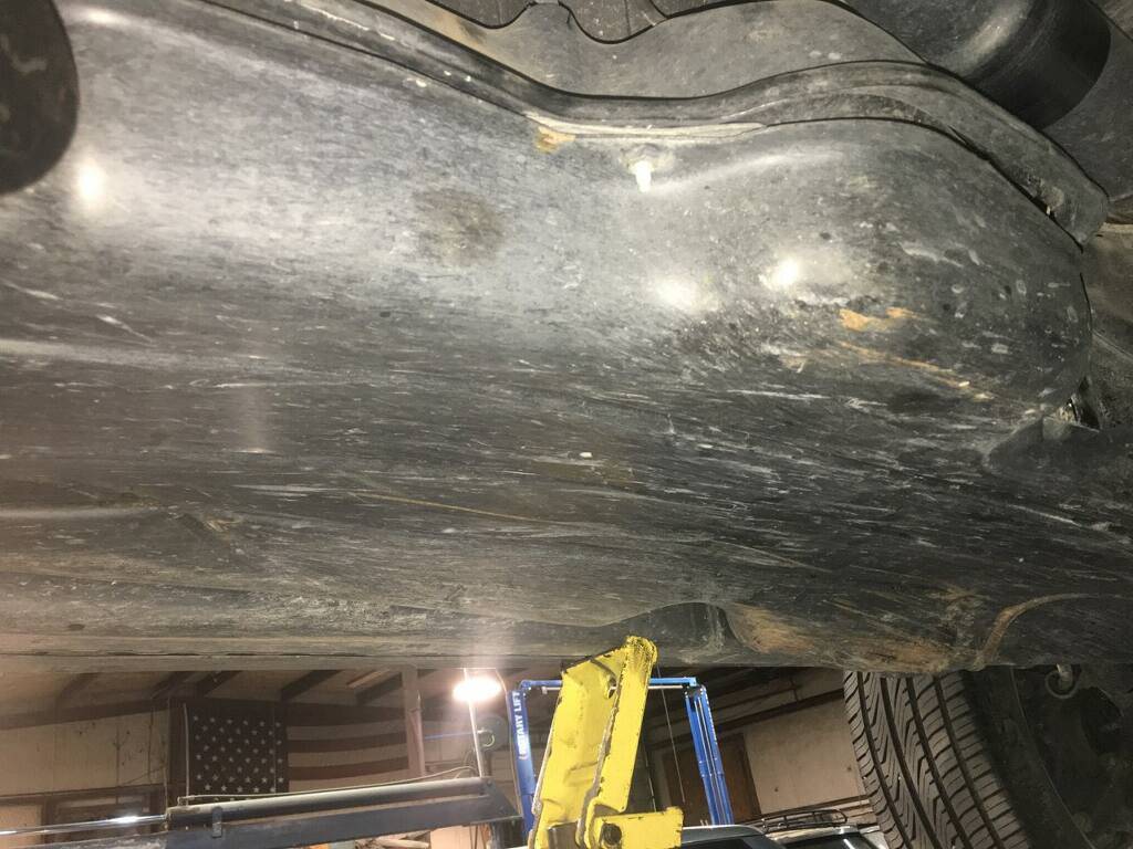

Just to follow up, here is what the underbelly looks like. Cracked exhaust, bent gas tank and a picture of the drive shaft which was being rubbed by the bent gas tank.
