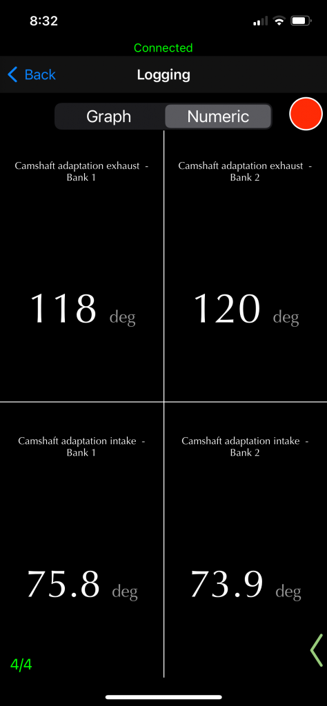

I don't think we have a thread like this, but I'd like to see more data from other users on their camshaft adaptation values, in relation to our timing chains stretching.
I'm not sure if this value should be taken on a cold or warm engine, but this is after a 25 mile drive. Taken while idling in park.
2013 V8, 122k miles.
Oil change interval of 7500 miles, running Mobil 1 EP 5W-20.
Engine sounds the same it always has.
Comes out to a 2.4° delta on the intake.

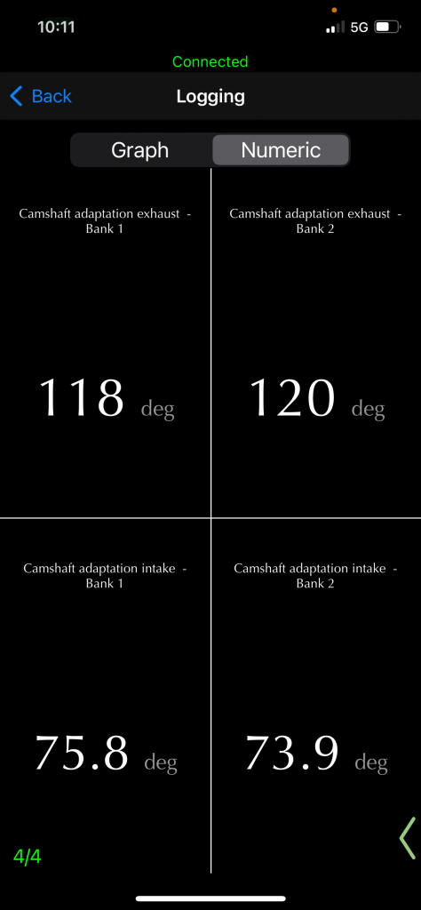

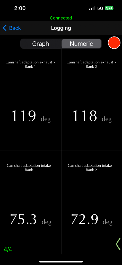

Here is mine from this morning. First picture was shortly after starting, sitting overnight. Second picture was after a 15 mile drive.
2013 V8, 123k miles
Oil change interval is 5000 miles, Redline 5W-20 since I purchased it with 112k miles. Factory serviced since new, no record of the chains or guides ever being replaced.
