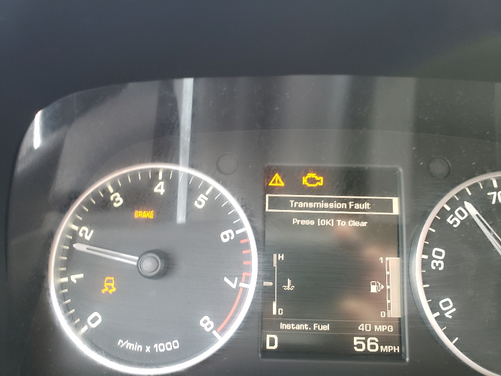

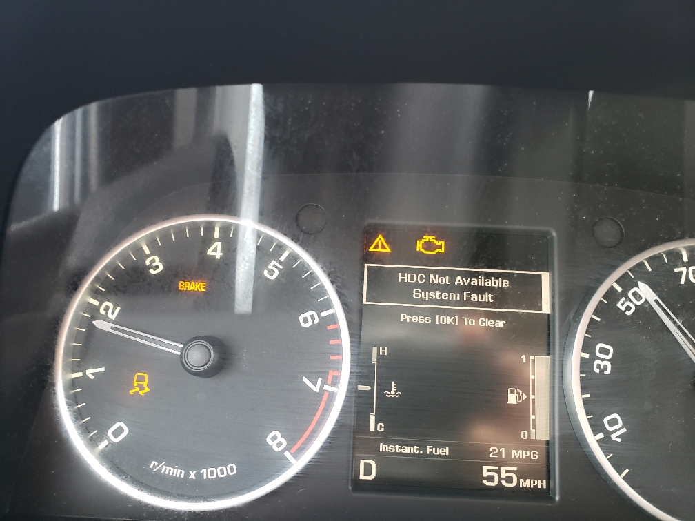

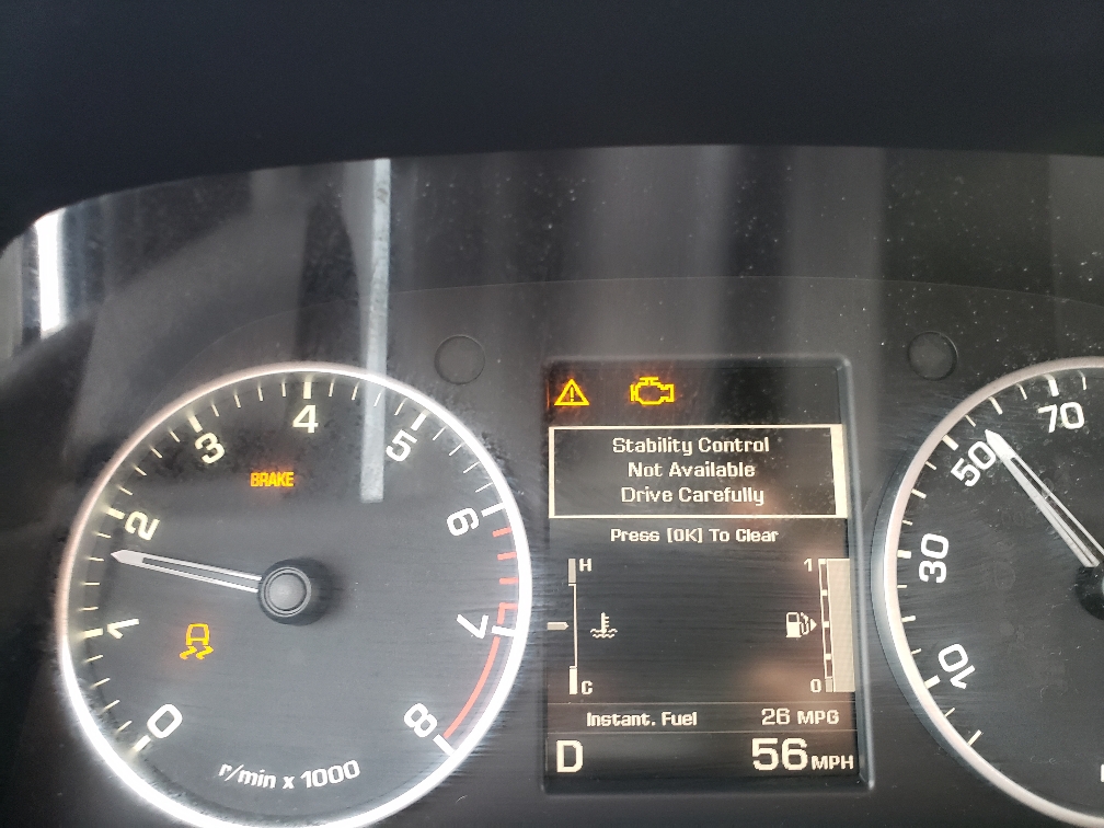

This just started today. I purchased the car about a week ago from a dealer in Ohio. Today I parked at home and when i started the car again and pulled out of the driveway it gave a warning about stability control, brake system, parking system sensors system unavailable, HDC, and transmission fault.
The vehicle will shift but will not downshift upon stopping. If you go back to park or turn off the vehicle and then select Drive it will start in 1st as expected. It acts almost as if the transmission is not getting the signal to shift.
Also, the air suspension is staying at the lowest setting.

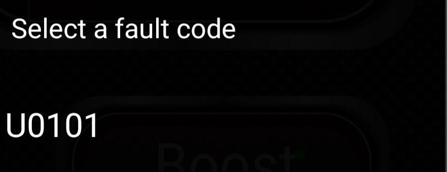

I have a very basic OBDll reader and was able to pull U0001 & U0101.
I'm assuming this is a TCM issue but it just seems odd to be all of sudden like this.
Any input is greatly appreciated!

**UPDATE**
Went to the mechanic this morning and from the start it ran perfectly fine.
Ran codes and looked at the modules, it hasn't happened again. At one point, it did have an alternator (generator) code so the thought is that the alternator is intermittently having voltage issues.
We will see if it does it again
Sent from my SM-G960U using Tapatalk
