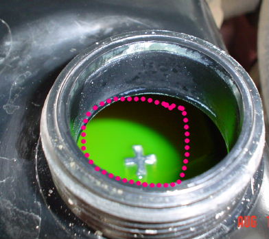

Mike--I cant find my cell phone..SH**!!! Here is a pic of the tank cold. I called my uncle about the problem .. He made me repeat after him: " I told u not to BUY a LR until you were done with school.. They are a maintenance/mechanical nightmare"... "Furthermore, they will leak everything known to man". I do not think I will be calling him again.. I will rely solely on the help from you EXPERT Land Rover Guru's.

PIC Of the Tank: That was some cool stuff.. Who ever came in and changed the post ...

OK, now that we have our own thread :biggrin: :
Now that you're at home (I assume), take a picture and post it in a couple more hours or so, so we can see if there's any real leak there. I remember seeing a pic from yesterday showing an awful lot of fluid above that cross thingy, so maybe yer just throwing excess fluid out. The couple of hours will give you time to check the clamps -- try drying the clamp ends of the hoses and wait to see if any fluid comes out of there, which would tell you there's a leak in the clamp....try to be methodical and scientific in this, and you can locate the leak (if there is one) pretty easily...

I'm wondering if the resivoir cap itself is bad, allowing fluid to leak? I know with other vehicles, the radiator cap will need replacing at some time or another. The same might be true with LR's????? Just a thought.
