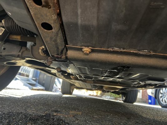

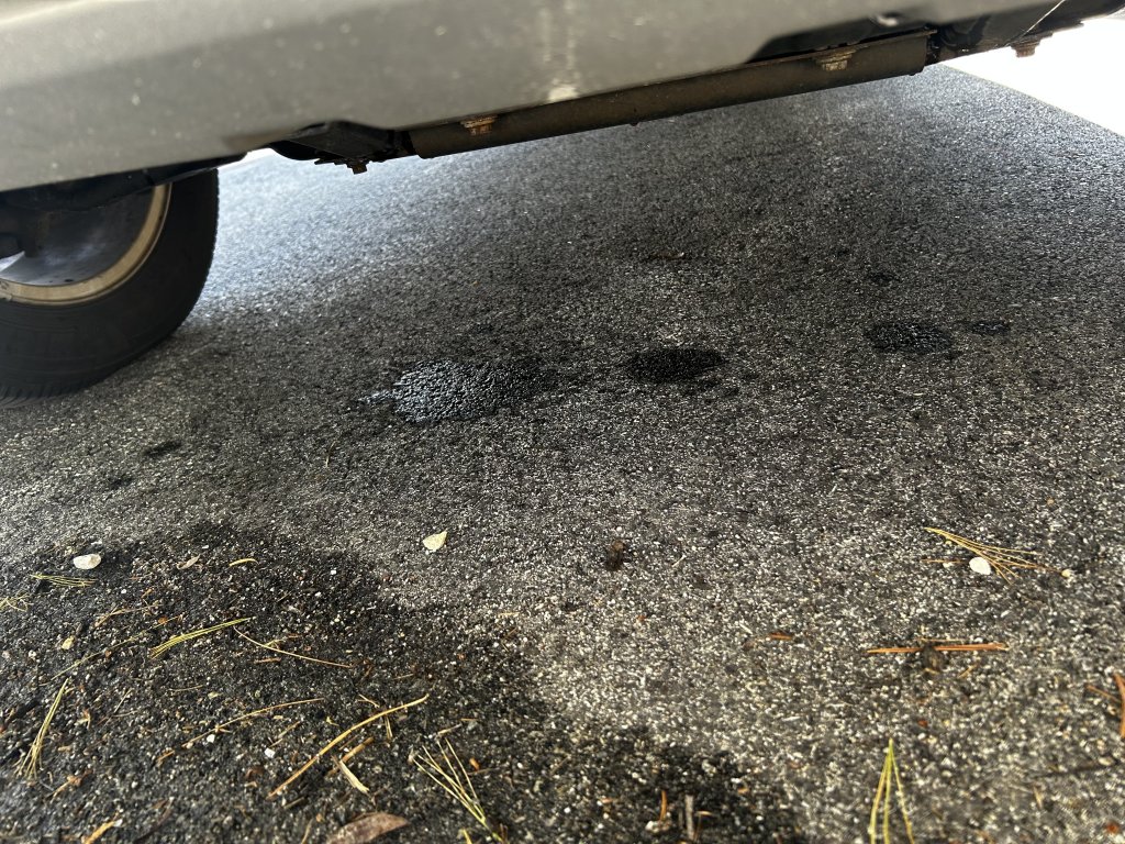

My 2014 LR4 with 97k miles on it is leaking coolant and a noticeable clip. The leak(s) are hitting the ground towards the front of the vehicle towards the passenger side. I have attached some pics. Any idea what kind a leak based from the pics that im looking at, hose, radiator etc. I know that its only speculation, just trying to get an idea.

Pop the hood and have a look - with that amount of coolant it should be straight forward to see what's wet and what's not.

The obvious questions are: How many miles on the vehicle? Have you replaced your crossover pipes, water pump, t-stat, etc.?
My guess is the front crossover pipe cracked. Hope you don't need to drive it soon... with a leak like that, it should stay parked.

Those crossover pipes can fail rapidly where the plastic breaks and the pump will push out all the coolant through the break. By the time the low coolant light comes on its too late and you could have serious repair bills. $14k for the engine by itself w/out installation.

Popped the hood. Looks like the leak is coming from the bottom of the front side between the pulleys and the fan. I had an 04 Discovery, which was somewhat simple to diagnose leaks. This seems like learning a new language. Either that or I'm a dumb dumb. Having it looked at in the morning by my mechanic whose at least qualified to find the source and if simple enough, fix. Otherwise having it towed next Thursday(first available) to my certified LR mechanic.

Well, my local regular car mechanic (HAHA) seems convinced that it's the water pump. I asked if he was sure, he said 85%. I then asked if it was a job he could/would do? he said yes i can, but I'm not touching these cars unless its oil, tires or brakes. hahahah. He's a good man to know when to say no or I don't know.

If it hasn't been replaced do the front crossover while you are there and use a OE Jaguar/LR water pump if possible.
