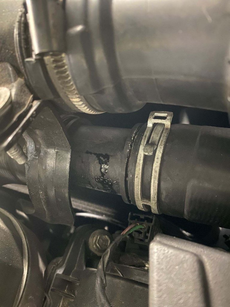

I think I have officially replaced every hose ever made for my LR4. Exhausting search for my latest leak.
Daveykid
Jan 14, 2022
107
27
Chicago

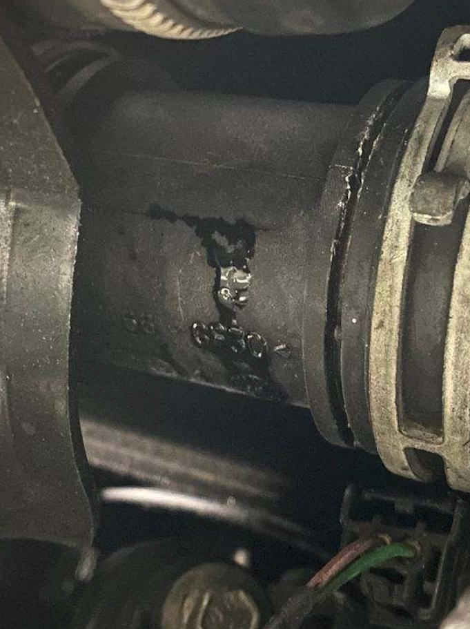

'15 LR4 and either through routine maintenance or necessity because it blew, I honestly can't think of any other coolant related hose that hasn't been replaced. The latest and I believe last (even according to my dealer) is this one. The hard ABS plastic section between the two large silicone hoses cracked horizontally and has created a slow leak. It's baffled me and the dealer for some time as it wasn't a more "visible" hose/leak and the leaking wasn't instantly happening. If I let the truck sit overnight sometimes there wouldn't be any leak. I suspect it might have been pooling on the inside of the skid plate, but I'm not sure on that one. Well, at least that one is solved.

That would be a good part to make out of metal instead of plastic.
Daveykid
Jan 14, 2022
107
27
Chicago
You are so spot on. There are so many parts that should be done that way but how else can you keep the aftermarket alive? All kidding aside so many parts are so poorly designed.

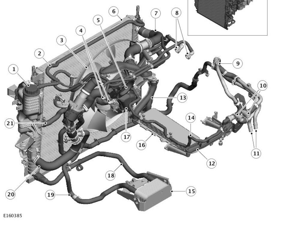

Yeah, these engines have very complex coolant circuits. All possible leaking spots that come to mind:
-Front and rear crossover pipes (sure you replaced those already)
-Water pump housing to engine block (bolts get corroded very easily here, need to tap the holes again when replacing these gaskets and install new bolts)
-Oil cooler pipe
-Thermostat housing
-Engine coolant sensor 2 housing
-Supercharger electric coolant pump
-Leaky bleed plugs
-An of course all the hoses
-Transmission fluid cooler
-Engine oil cooler
And then since we don´t have a dipstick we can´t check that easily if coolant if mixing with engine oil, you can vacuum out a sample every now and then.
My front crossover pipe started to fail at about 10k miles.
Vacuum test for the coolant system should be -0.8 bar or -12 psi for 1 minute.

Thanks for the punch list and the (nightmarish) diagram. Could it get any more "complex"?...and then, to keep it interesting, throw in some inferior parts that could cost an engine.
