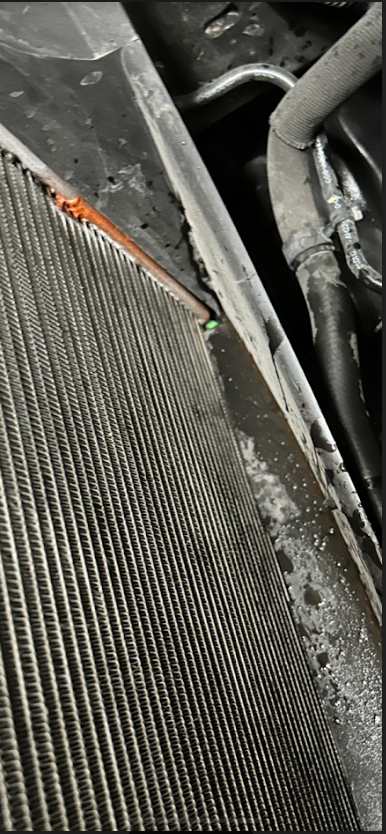

I've got a 1/3 gal of Land Rover coolant that I carry around and plenty of water. I trust my LR4 now and so far so good. All the plastic crossovers and t-stat are fresh. This is my rad leak from going through the timing chain last month. It was replaced with a Land Rover brand radiator, but the rad hoses were re-used.

I'm glad I've swapped over to dexcool a few years ago. I dumped 1.5 gallons of dexcool to get home, about 250 miles away. Imagine trying to find Land Rover coolant in an emergency, good luck. Moral of the story, be prepared and when you encounter an issue be over-prepared. So, you won't be stuck in the same scenario. I guess I could have dumped water into it, but it was at freezing temps. I can't fathom towing the truck 250 miles back home.
I have a new radiator on the way, 10 more days... :rolleyes:
