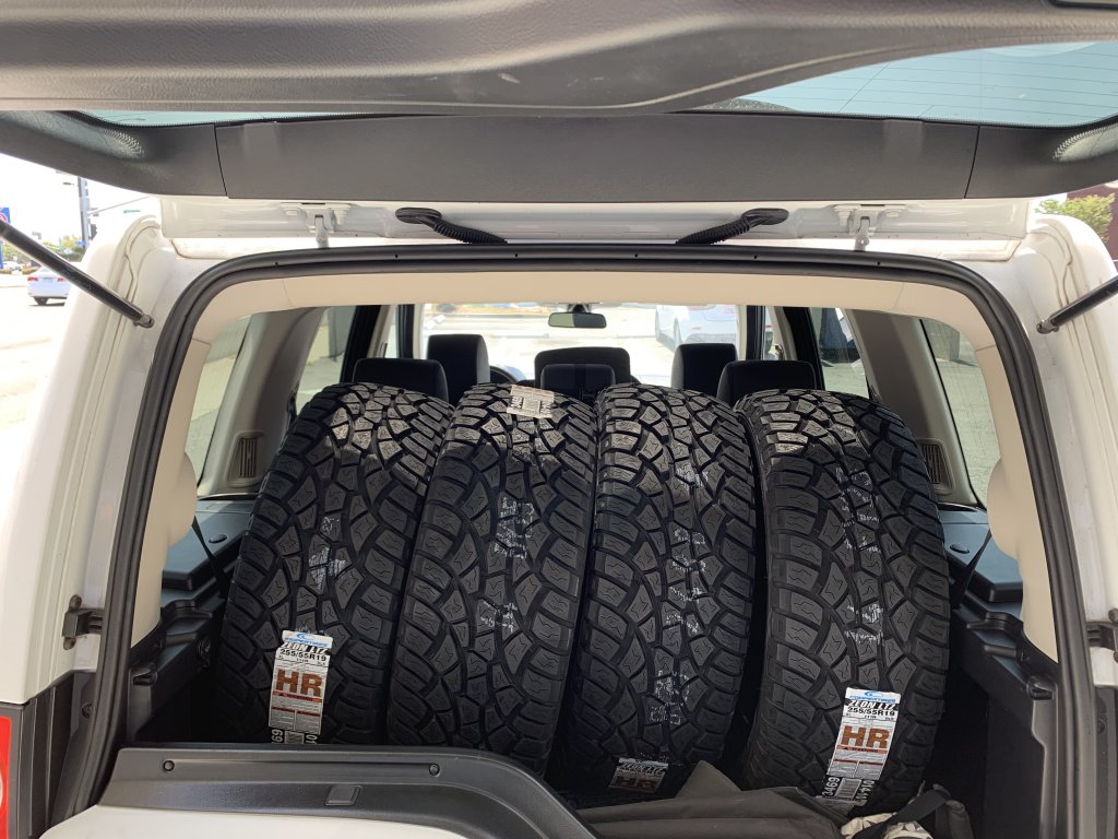

Can I get these for my 2008 LR3? When I go to the Discount Tire website, I get an alert saying that these tires won't fit my vehicle.
They are on sale at Walmart, I think of you print the price and take that to discount tire they might match the price.

Yes, they will physically fit on your LR3's 19" rims.

You get an alert because Land Rover recommends V speed rated tires. Cooper Zeons i believe are H rated tires? It doesn't matter because V tires are for up to 149MPH. H are for up to 130 MPH. I doubt you ever touch 110 MPH so you should be fine.

Actually was going to post the same thing! I just picked mine up, had my eye on them since we bought the truck.
