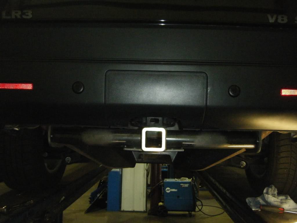

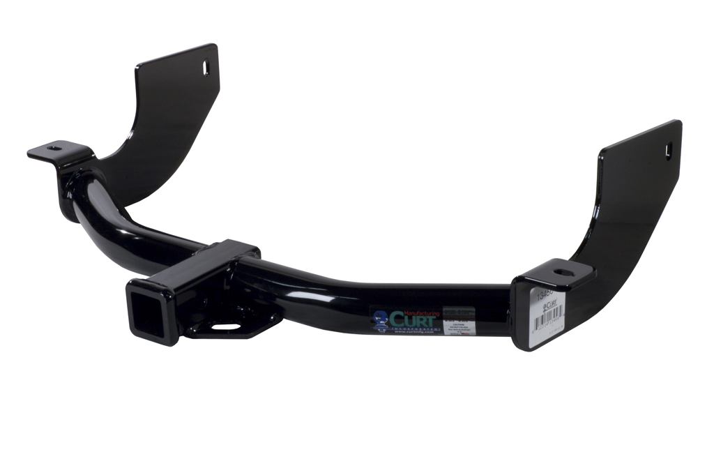

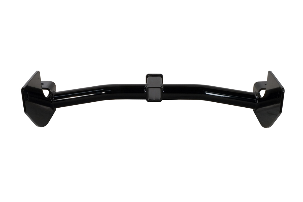

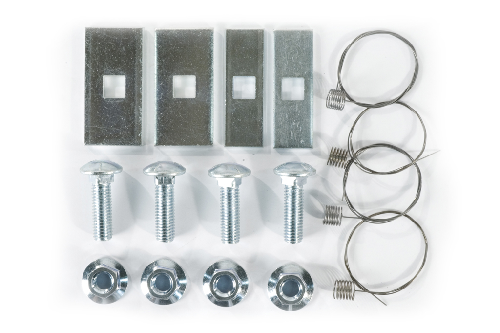

The link below is to a number of trailer hitch and trailer wiring files for my LR3. Some of them may be of value re the LR4, in particular the ones related to the electric brake wiring.
As to the Curt Hitch, per the attached install instruction pdf, it is bolt on for both the LR3 and LR4 - same part number for both.
This is the link for the 2" class III Curt hitch specific to the LR3/4, part number 13456.
Curt Hitch on 08 LANDROVER LR3 4-29-09013.jpgFasteners 13456_1024x768_e.jpgCurt Hitch on 08 LANDROVER LR3 4-29-09013.jpg
