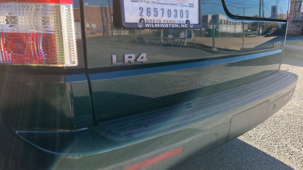

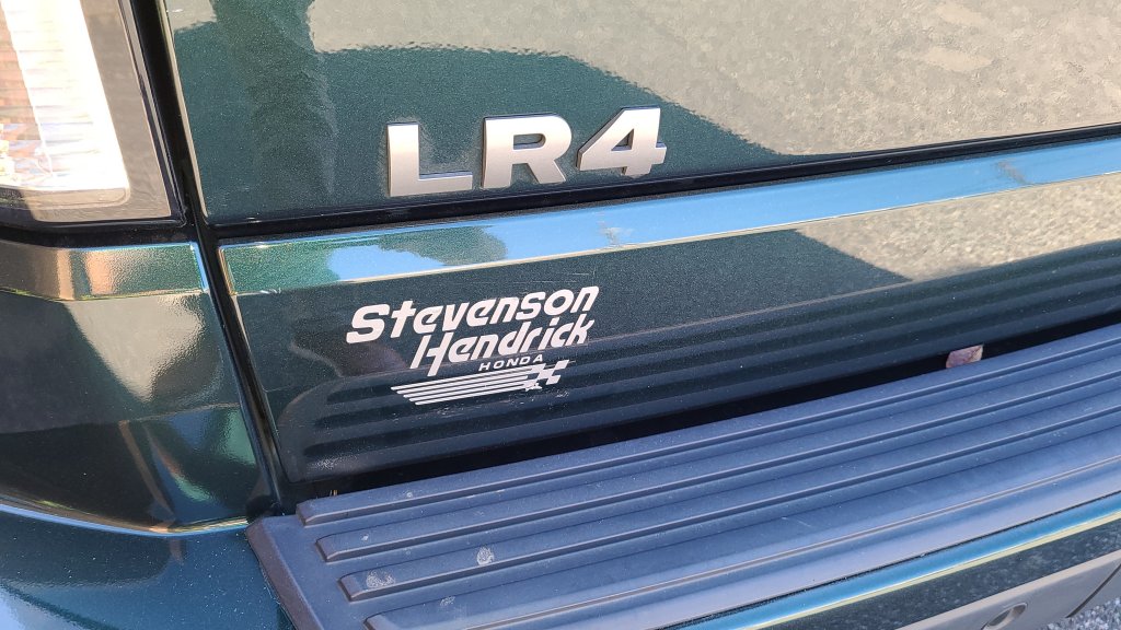

Just removed the god awful dealer sticker on the rear, lol.

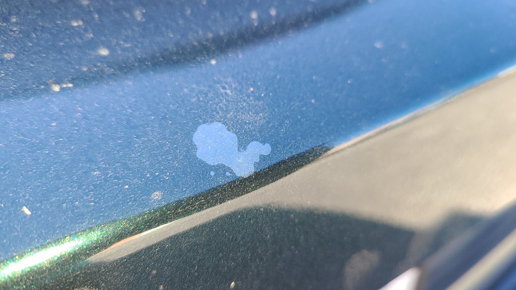

Got this nasty clear coat bubble i need to address. Anyone have any tips?

wash.
iron remover. i prefer Iron-x.
clay
polish. i use meguiars M82 and M105 for paint correction and polishing. I assume since your asking this that you're new to polishing? so use a random orbital polisher, rather than a rotary.
top coat. ive coated all my cars with carpro cquartz UK 3.0 ceramic coating, topped off with car pro reload spray.
give it a spray down with ironx once per year ( i do mine in spring) a top coat of the reload spray 2x per year (spring and fall), and the ceramic coat should last 3 years before needing any reapplication.
I dont think you will remove the spot. appears to be early stages of clear coat de-lamination. best you can do is prevent it from getting worse by maintaining the paint.

Robert, that was truly a hideous dealer sticker. After you hit it with Goo-Gone I hope you sprinkled some holy water on it for good measure.
