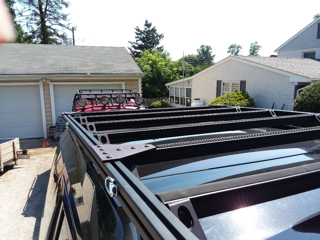

Roof Rack for LR4 I made from black anodized 80/20 T slot aluminium.
Another view showing the anti-slip tread from 80/20 note the 1998 Discovery (series 1) in the background.

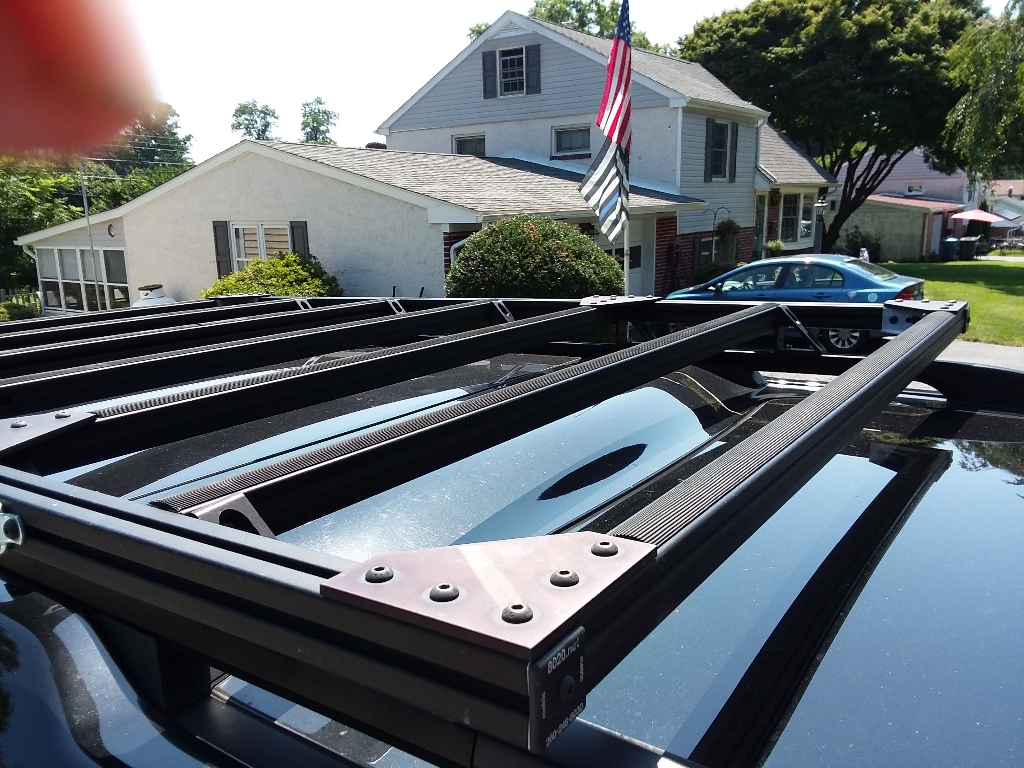

Here are a couple more if you are interested.
Roof Rack I made for an LR4 using 80/20 T slot aluminum (img 3). Note the 90 deg brackets at all 4 corners.

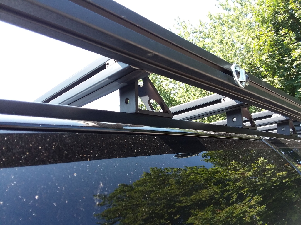

This shows mounting brackets are black 80/20 open triangles to connect the factory full length roof track to the 80/20 T slot. The mounting plate that holds the brackets are within the LR Factory slot required custom work to modify bar aluminium to the correct size and a rabbit on the underside of the bar stock to accommodate a T bolt ( like those to hold a toilet). I cut that to size using a carbide blade on my table saw. Sorry no dimensions, I just messed around until it fit on the track and the toilet bolt fit in the rabbit. I chose non-rusting hardware such as aluminium and stainless when I could. Stainless and aluminium get along with each other but steel and aluminium or stainless especially do not like each other and will electro-chemically react and corrode.
You can also see the 90 deg brackets I used to hold the cross bars to the log rails. Note the D ring mounted in the T slot.
One more think it makes a low tone whistle from the wind blowing over the T slots. I filled these with rubber t Slot filler strips The top ones are non skid and UV resistant, but a bit pricey The others are there much less expensive filler strips. You can save yourself ordering the T Slot profiles without a slot on the bottom but 80/20 may charge more for that profile vs the filler strips.
