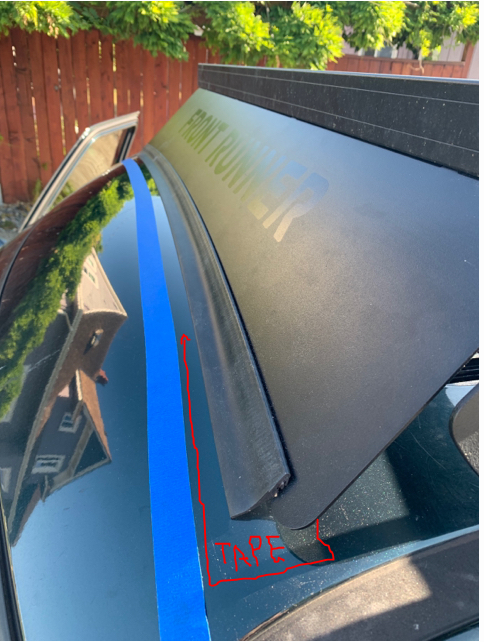

1. Yes, install the rack to the roof of the rover before trying to attach the fairing. There is easy access to the under side of the rack even while it is on the car. I used the sun roof but I could have also done it while sitting on top of the rack. You put the bolts loosely into the track on the bottom of the rack, and then the fairing slots onto the bolts.
2. Yep. I figure it's impossible to lay down the protective tape while the fairing is installed, but it's also really hard to figure out where to put the protective stuff if the fairing isn't on at all. The blue painter's tape goes down to trace the line where the fairing makes contact with the roof (I did 1/2" away from the rubber so there wouldn't be much protective plastic showing after the fairing was back on). It's a gently curving line so you can't just mark the two edges and pull a straight line across.

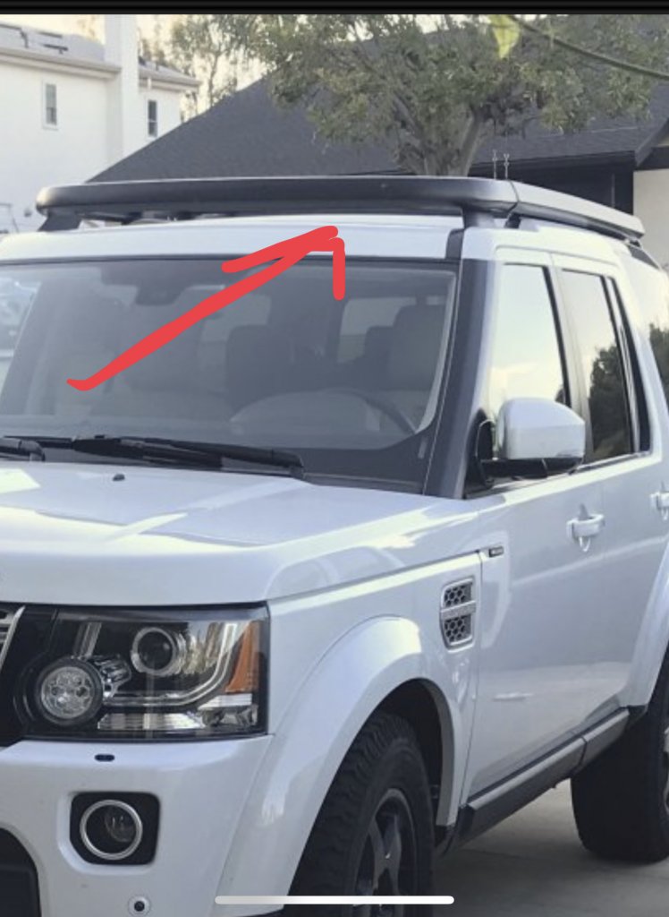

3. Yep. The clear tape they send is somewhat stretchy, so start at one side and press it down nice and secure, then work your way across stretching it and pressing it down so that it follows the curve that you marked with the painter's tape. Your yellow arrows are right, it's like a clear packing tape with a bit more body to it, you can see all the wrinkles and bubbles that I put in mine by doing it wrong a couple times and having to pull it back up.
4. You bet, remove the blue tape after you have the protective stuff in place, then re-mount the fairing and tighten everything down. This is probably a 20 minute job unless you're like me and want to do it wrong a couple times first :)
The idea is to get the protective tape right here, and have it stick out an even amount in the front where people might be able to see it:

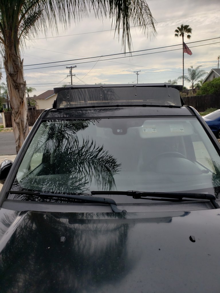

Here's my diy wind fairing. I did this before FRO had one, and would still would have made one after it was released. I have the FRO light bar mounted to the bottom of the front rack, so it wouldn't work for me.
My wind fairing does a few things, keep the led light bar secured and dust off the lens, allows me to open my sun roof to open the led light bar shield, and pushes air up along the same angle as the windshield. And yes, it's tinted polycarbonate.
