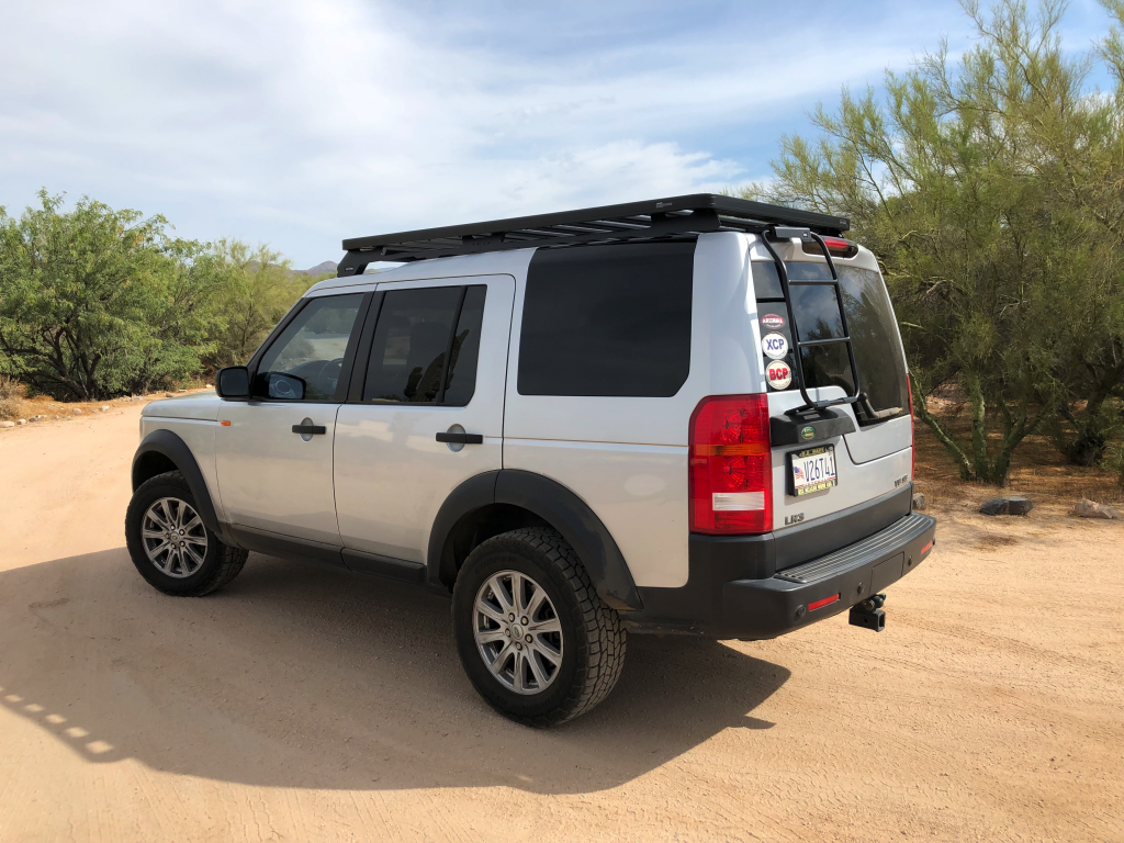

I just installed a full length Front Runner rack to my LR3 that only had short rails. I had to remove the cap in the front protector channel as well as the existing short rails = that exposes the holes that would have been used by your full length rails. The Front Runner mounting system ONLY used the factory holes that were present - no drilling or trimming required. View attachment 9803
Your LR3 looks great, thanks for the info on the Front Runner, I'll definitely take a look at them. I like the flat rack style.

When i pulled off the short rails to install the Front Runner rack there was a lot of leaves, clumped dirt, etc beneath. Same goes for the the front strips covering the lower part of the roofline so even if you do install/make new channel covers I doubt it will keep much out. That said, as long as all of the actual threaded bolt holes are filled with either a well-fitting bolt or sealed over some how, I don't see how any water can get into the vehicle as the channel is actually molded into the metal of the roof with no visible *********** points - save for the threaded holes. Even those don't appear to go through to roof itself but rather some sort of nut welded into the shaped roof so even if left open I still don't think a *********** point for water to enter vehicle.
