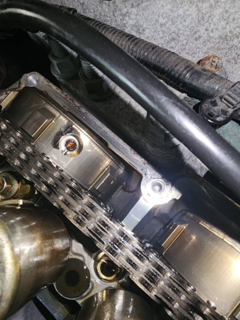

Could use some advice, 2016 Sport about 90k, timing chain throwing service engine light.
Two Indy's recommend complete engine swap, neither will touch the top end. Used engine with 1 year warranty about $12k.

Engine swap? Are they out of their mind?
The cam timing drivetrain need to be replaced. Both VVT sprockets, timing chain, guides and timing chain tensioner.
