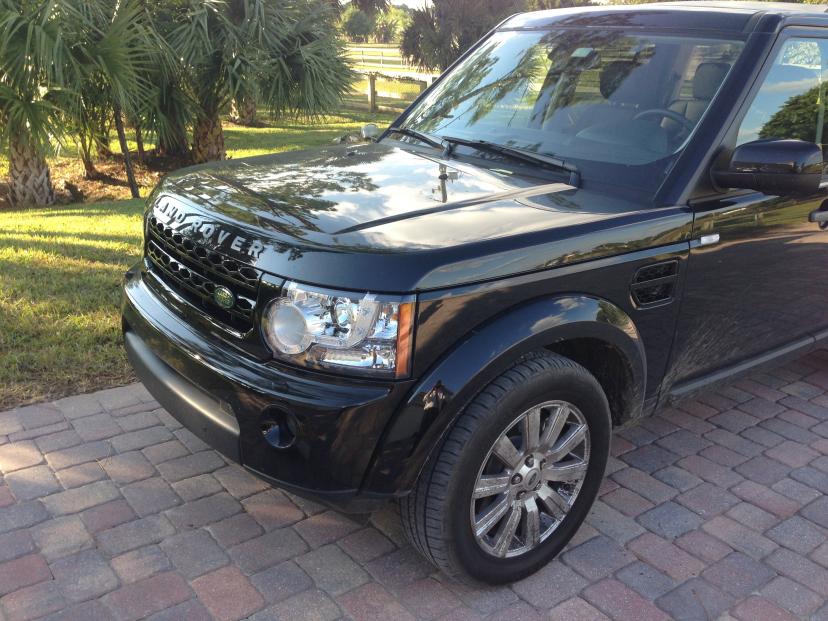

A lil dirty in this pic, only put 10k on them.
