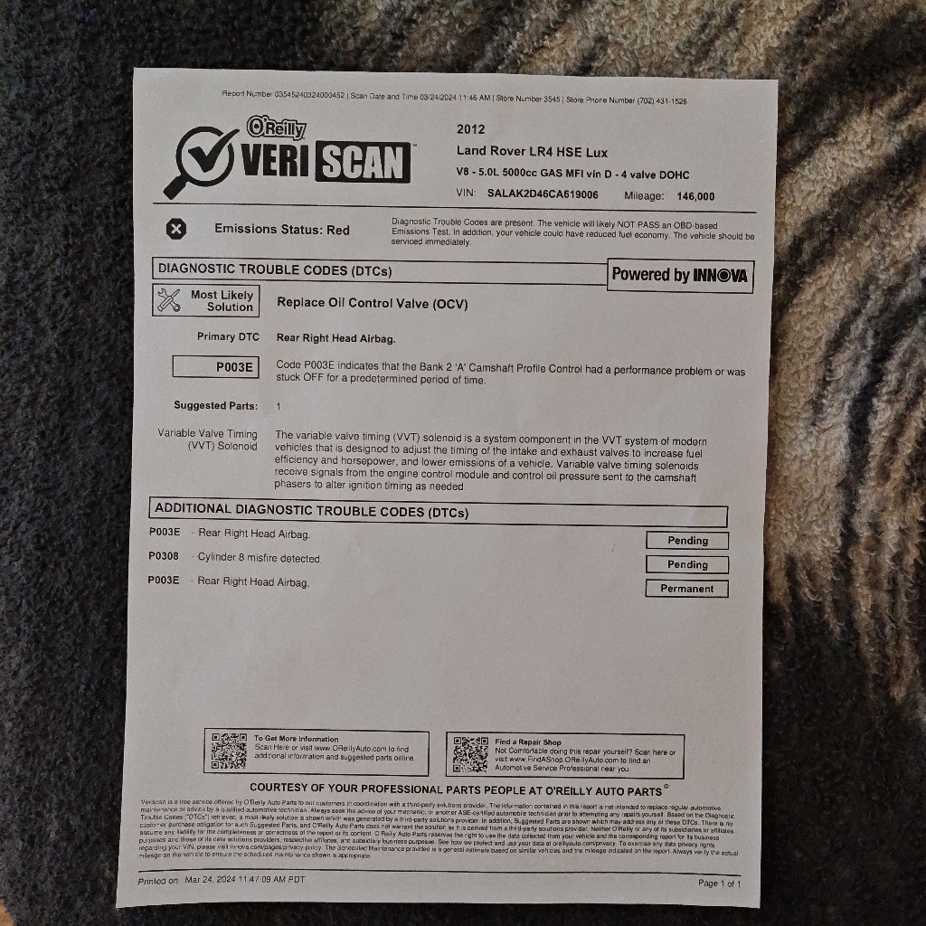

Driving on the freeway the other day the engine fell on its face for the first time ever and the yellow check engine light started flashing. I pull off and it seems like its running on 4 cylinders so I'm cruising to find a good spot to park and the yellow light shuts off. Then I park, pull the battery cable and then it starts right up and it runs on all 8. Strong as ever and it was like nothing ever happened.

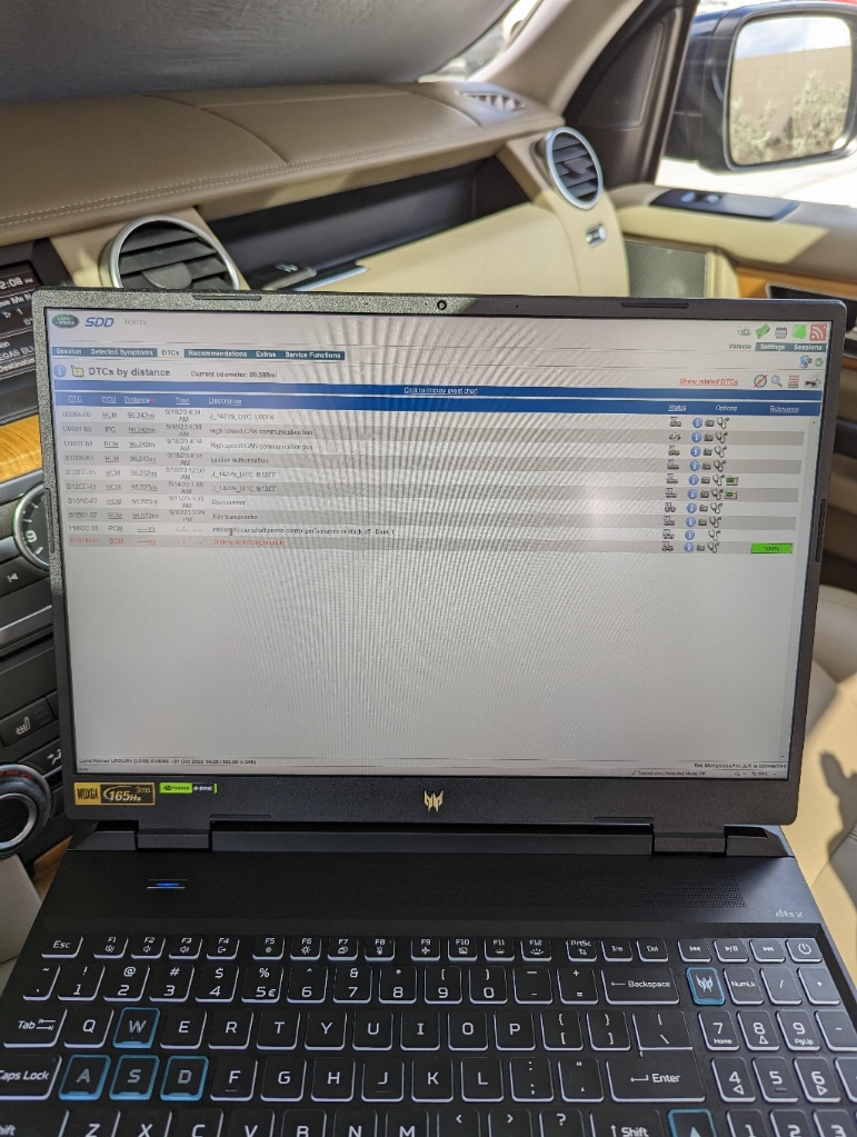

Then that problem happened 2 more times so now I can't trust it on the freeway unless I'm driving with a light throttle in D. I tried pulling the codes but the SDD software crack failed and I didn't get it going again. Then that other company that everyone raves about wouldn't sell me their device because they thought I'd steal it. They refunded my money after purchase.
So today I tried O'Reillys and asked them what I needed to buy to read a code. They go out to your car, plug in a reader and give you a printout for free. It looks like I've got a serious expensive issue and some of the text on the printout is wrong and/or confusing. It isn't clear what the primary DTC is, but I think it is "P003E - "A" Camshaft Profile Control Performance/Stuck Off." and then there is a misfire detected. Any ideas on what could be the issue?

I have an old snapshot from 3k miles ago before winter that has a P003C code but the printout says the current code is different, P003E. Is it the same trouble code? The check engine light wasn't on when I pulled the codes on the laptop
