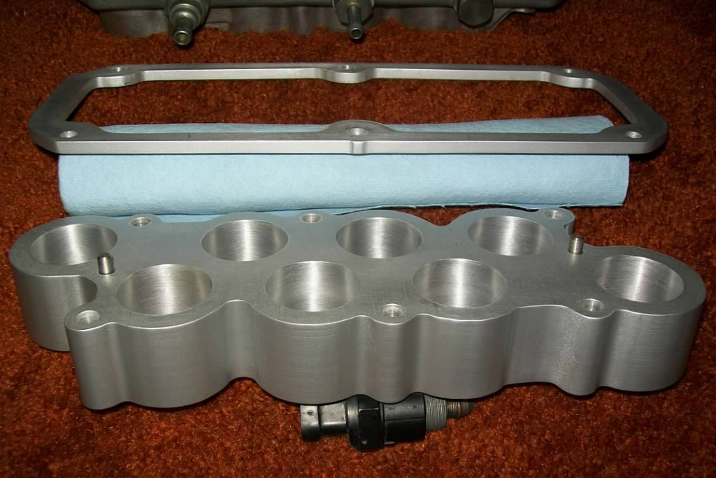

More importantly low end Tq really shines with a 5 spd tranny. This is why I milled out a 1 1/2" thick aluminum intake extension spacer lowering max Tq to 2,715 rpm's. This made a huge diference in low end Tq still able to pull to 5,400 rpm's. No reason past 5,200. Ran all the engine build numbers and specs from ram cold air intake to exhaust (Borla) on back to tip including top of ram tube bell lengths to valves as they have different length runners as well did each volume in cc's. Engine specs then run through a NASCAR engine program ending up with the above 2,715 rpm's numbers.
Going with a 4.9 stroker crank, larger valves with mild porting and larger throttle butterfly returning 250 Hp with 340 Tq looking factory stock passing the smog visual and sniff test being plated in Kalifornia.

I went this direction on the 4.6 engine and had results way better than expected.....~~=o&o>.......
