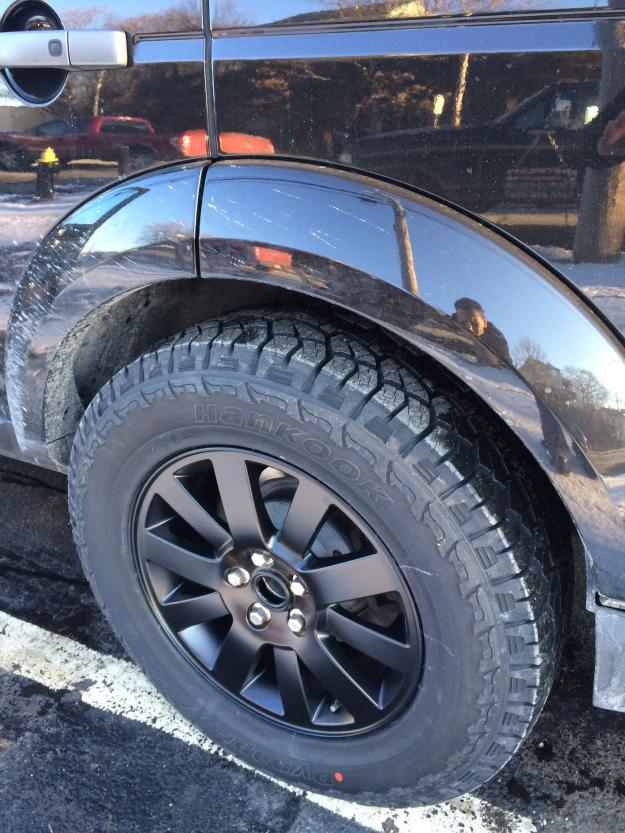

Just ordered the Hankook Dynapro RF10 ATm in 265/65R18.
I only read great things about them (even on snow).
Congratulations! I think those tires will be great. Can't wait to hear more.

Added a couple pictures in the show off thread.
