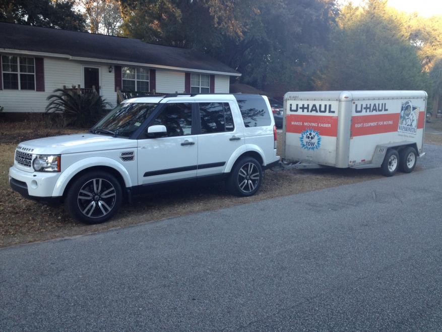

Oops meant 285/50
Thoughts too wide?
I had 265 50 on my '11 LR4 and had a nice stance.
Anyone have rear end picture of 285s installed?
Planning same rims as my previous '11 pictured below.
285/50x20 on a 9" wide wheel looks awesome! It looks just right in fact. 10 years ago that's what I had on my lr3 with the RR "stormer" 20" wheels. It was impractical but provided great cornering on interstates at 80 mph and looked perfect because the wider wheel gets a more flush fender edge look.
