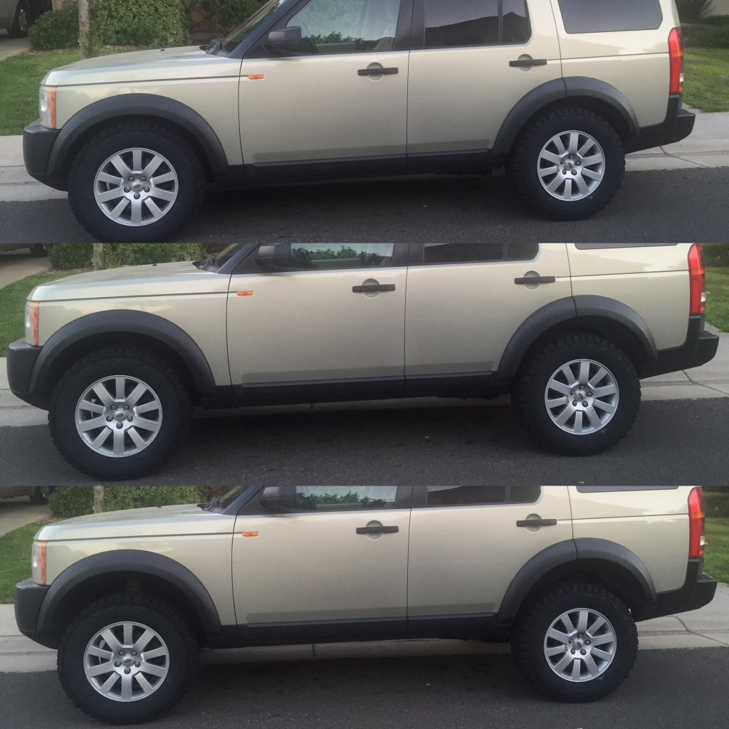

I picked up the BFG TKO2s 275/65/18 and super happy. Added the Johnson Rods and have been riding smooth since July. Super happy I went this direction.
Here is a pick with the tires at all three ride heighths.

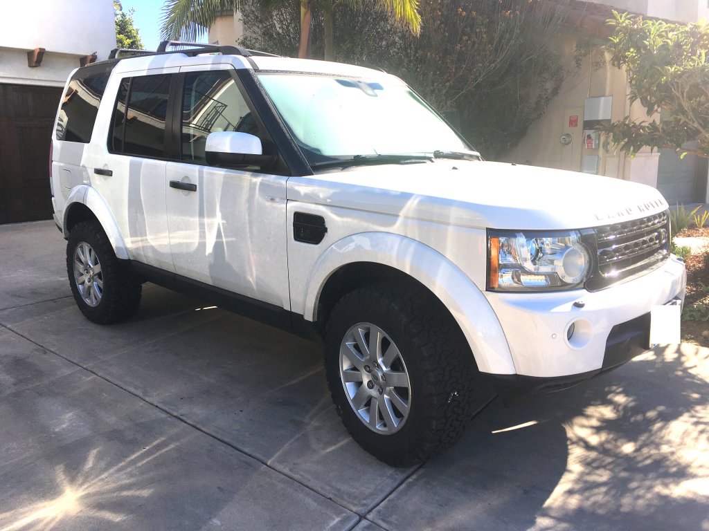

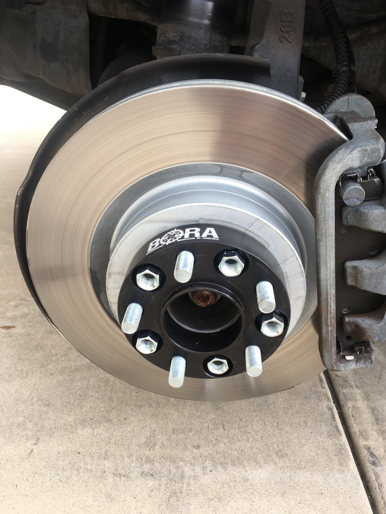

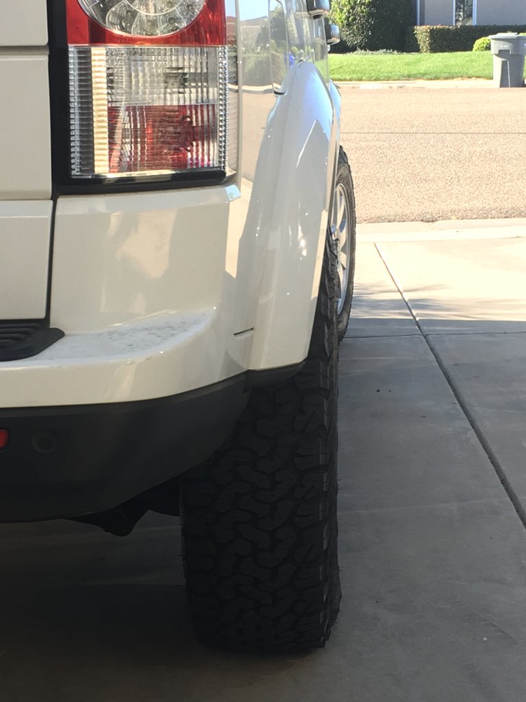

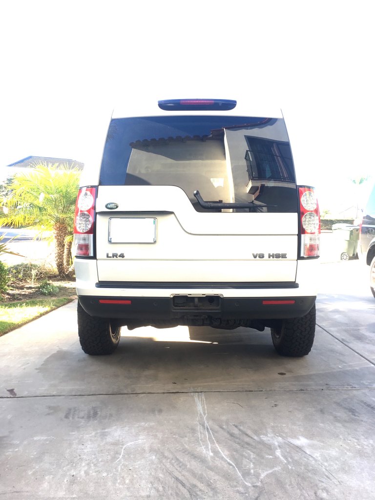

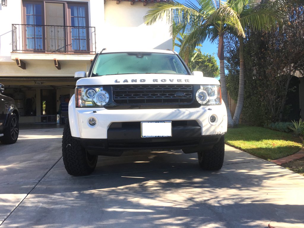

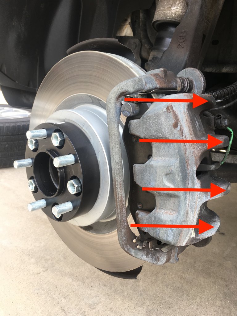

I just mounted 265/65/18 KO2s (on LR3 OEM18" wheels) on my LR4 with 1.25" spacers.
I still had to shave the calipers about 1-2mm using a metal file. (See arrows on photo) Its the 4 fins on the back of the calipers that touch ...just.
The spare just went in but only fully deflated.
The TPMS from the old 19" wheels transferred fine to the new 18" wheels.
Here are the photos:

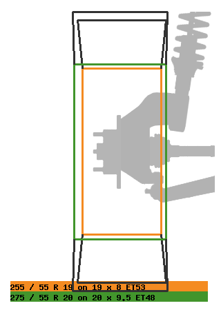

How do you determine if you need spacers? Going from 255/55/19 (53 off set I believe) to 275/55/20 (48)
I found this calculator and it provided a visual and the following detail:
"Compared to your existing wheel, this new wheel will have an inner rim which is 14.1mm closer to the suspension strut. The outer rim will poke out 24.1mm more than before"
Thanks in advance for input.
