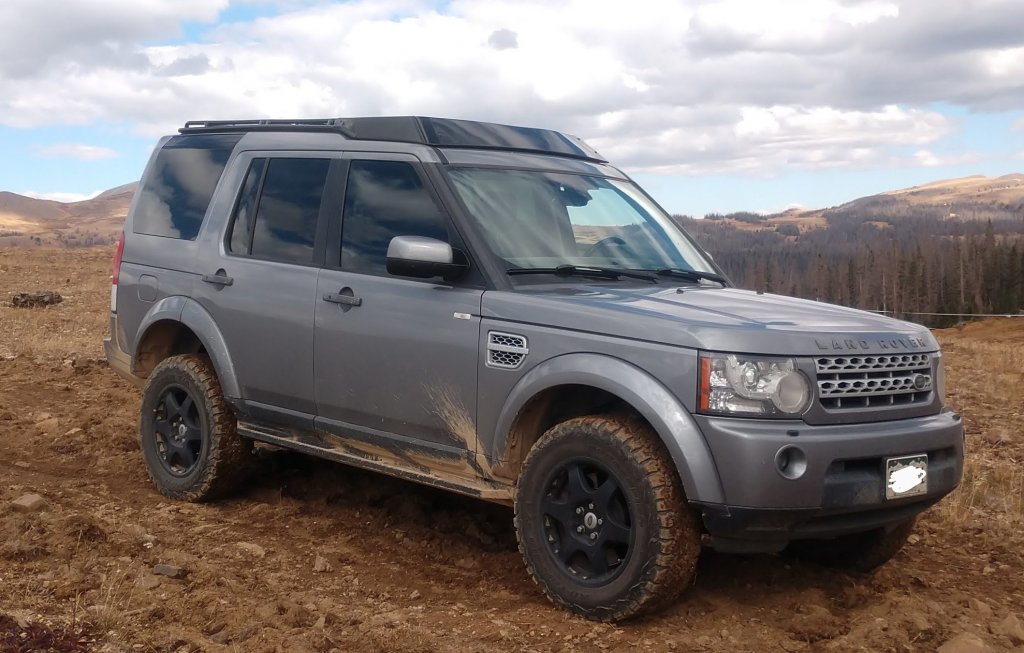

I put the Defender 18" steelies on my LR4 about 5 weeks ago. After over 5 years of thinking of 18" wheels and dreaming of the tire possibilities over the standard 19" wheels, I was actually sort of let down by the options when it came time to figure out what tires I actually wanted. What I learned is this: in my point of view, there are only a few "best" tire options for an 18" wheel on an LR4, so long as you want to stick with the sizes that won't create issues if your air springs fail and the Rover drops to the bump stops (and you do not have the SYA kit). Those tire sizes are 265/65/18 or 285/60/18.

So, when it was all said and done, I wound up just going with the boring old BFG All-Terrains. Not really in love with the sidewall tread on these (the sidewall tread looks more aggressive than the actual tread does), but in terms of all the parameters, they were probably the best tire for me.
I should note that another tire size works if you are limiting yourself to tires that would still function if you drop to your bumpstops: 285/60/18. A bit wider but with a tiniest lower overall diameter than the 265/65/18. That size gives you the option of General tires that would also work. I'm just a bigger fan of skinny tires versus wide, though.
