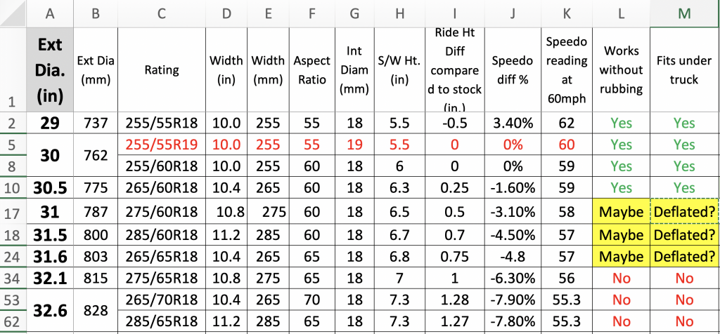

I'm making some revisions to my post and updating / simplifying the embedded spreadsheet as I'm sure more people can make use of this. If any of y'all would not mind helping can we all pretty much agree on the highlighted cells here, namely that 30.5" ext dia. tires and smaller fit without rubbing AND fit under the truck, that 31-31.6" dia tires MAY have some rubbing and MAY have some tightness under the truck, and that once you cross over into the 32.1 and higher, you will definitely have rubbing and also will not be able to fit the spare under the truck? I know this has been beaten to death but I can only read 90 pages of forum posts so many times. :) Hoping to make this a permanent useful post for people.
Nice work, Troy! I have Compos + KO2s 265/65/18 now (also have a set of 265/60 Coopers) and confirm your findings. I have not removed the heat shield but I have preventively deflated the spare. And it was still a bit of work to get it there, so I assume an inflated one would be near-impossible to get in - and possibly to get out!
I can't but recommend Troy's article to everyone. As said elsewhere, I've run the Compos + Cooper Discoverer S/T Maxx 265/60/18 tyres over more than 30.000 km of difficult Central Asian terrain (and including asphalt so horribly potted it put any mountain track to shame) with the car very heavily loaded and have experienced no issues.
