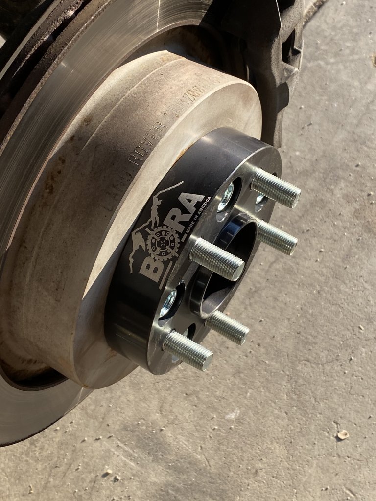

If you did end up going the spacer route, I can't recommend Bulletproof Off Road Adapters highly enough. I just got a set from them and they are a serious work of art. Made to order in the USA. Tough to beat.

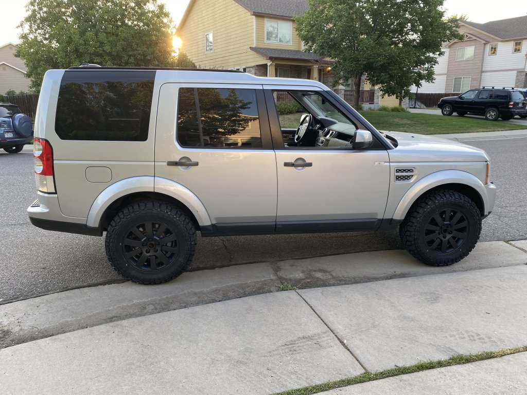

I would have preferred a wheel where spacers weren't needed but the price on a set of (for me) off road wheels that will get scratched and beat up was way out of line. I picked up a set of trashed LR3 10-spokes for a song. Stripped them, sanded and rattle canned with Steel-IT and I couldn't be happier with the results. When they get scratched, it is a snap to touch them up.
Damn, those look good. Now I'm looking on Craigslist for trashed LR3 wheels...

So just FYI in case anyone else is planning to really off road their rig - after this weekend, I am really glad I went the rattle can Steel-IT route. I ran Middle Fork of the St. Vrain trail outside Boulder. It is a pretty solid moderate trail. Had to really pick lines and stack rocks in 2 spots (at least I did) and I scratched the living crap out of the wheels. Had I paid top dollar for them, I'd be crying today. A little pressure wash and a touch up with the can and I'm back in business. The design of the lr3 wheel lends itself to getting scratched on a rocky trail.
Wheels get mangled in real terrain. No real way around it. It's a badge of honor.
