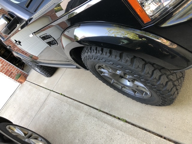

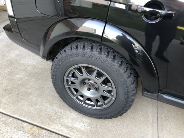

Hi all, I’ve just fit the Evo Corse wheels with ST Maxx in 265 65 18.

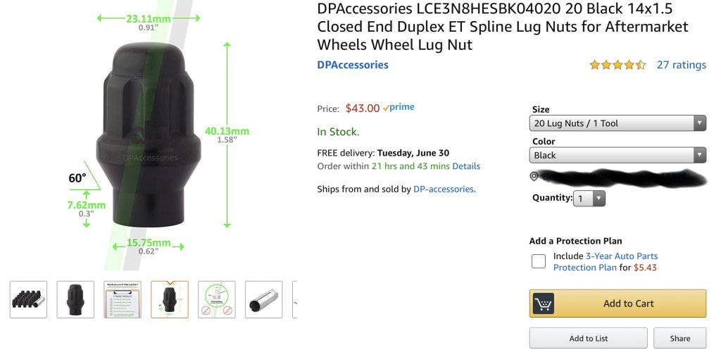

I really love those EVOs. Was hoping to get a set soon. Did you get 5 to include a spare? If so, how did the spare fitting go? Did you keep the TPMS? And, which lug nuts did you get?
b.anzellotti
Dec 21, 2015
18
I didn’t get the 5th wheel yet. I was able to transfer over the TPMS no problem. However I never thought about that I could disable with the GAP tool. Probably would have if I knew ahead of time.
The wheel nuts were confusing at first but a picture helped. I went with the DP Accessories ones in black.

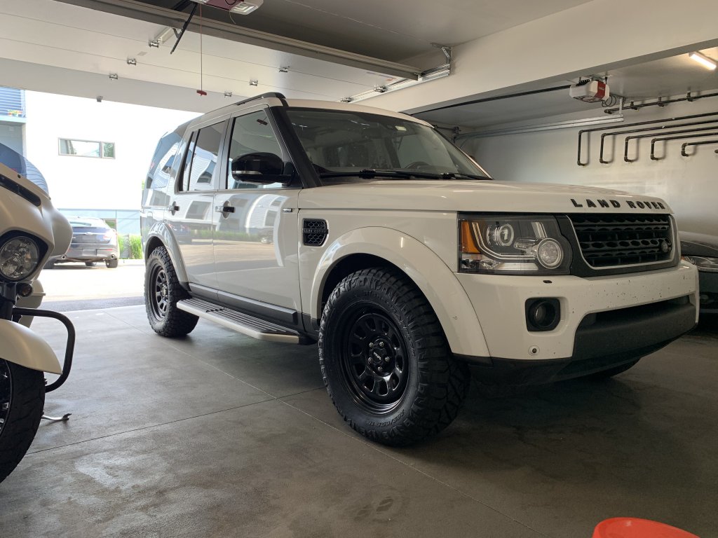

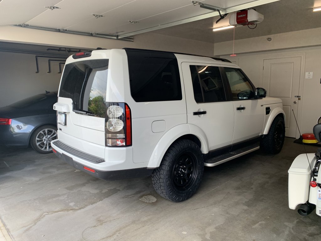

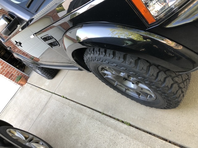

So i finally got the 265/65 R18 Nitto Ridge Grapplers put on the TuffAnt MKII ET27's. Such a gnarly lookin' tire, and the rims really complement the look of the truck. I am beyond happy with the overall look.
*QUESTION!
I had them install new TPMS sensors (315/433 EZ Schrader 33520) but when I scroll through my dashboard items I have no menu available to check in on my tire pressure. Is this not available on the LR4's to see a visual representation? I could have SWORN there was an option for this, but I've never had it so I assumed I didn't have the sensors. Is it only for the warning light?
