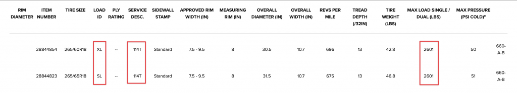

Here's something I couldn't figure out. The tire I ultimately was most interested in was the Falken Wildpeak AT4W, however I determined the LT size was going to be too large physically to work without modification. However what I thought was strange was that the 265/60 is XL rated, while the 265/65 is SL rated, yet if you compare their load indexes, they're identical. Why would one be XL and the other SL?
I'm pretty sure they compare the weight rating vs the size to determine SL or XL. If you look at the XL 225/65R17, it's only 106T at 28.5" whereas the SL 265/70R17 is 115T at 31.7".
I really wish the 265/65R18 E rated was 31.5" too. 31.7" is pushing it.
