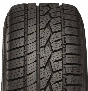

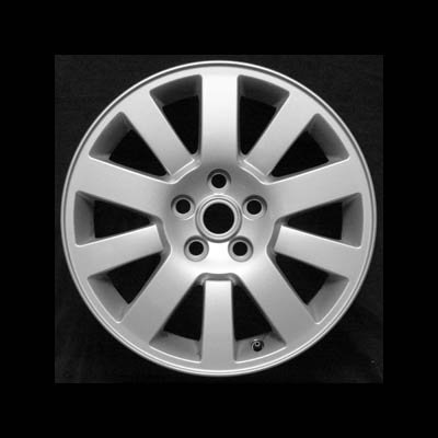

Ice and snow plus potholes are my main concern re my grocery getter. Many years back, it switched out the factory 19" HSE rims for factory 18" Cromodora rims. I then installed 235 65 R18 tyres which gives me a narrower tread but taller rubber between the road and the rim.
Other than stocking availability concerns, I have had what I call good luck with Toyo Celsius CUV (Cute Utility Vehicle) rubber.
For me, the tread seems to work. It is quiet on pavement and ice and snow traction seems OK. My view is that no tyre tread is really any good relative to running on dry pavement, but I regard the narrow tread as sticking better in ice and snow, and that includes wet pavement. For me, up here, what I regard as the wide sand tyres are not the best.
I now have about 290,000 miles (470,000 km) on my LR3.

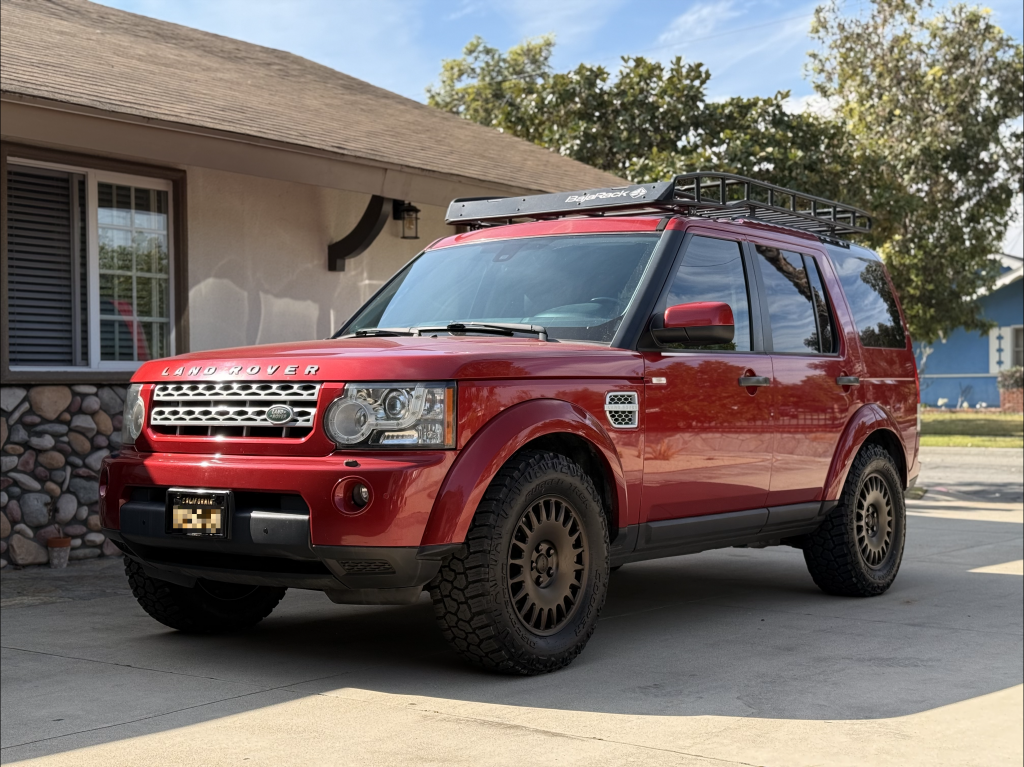

Well the wheels and tires went on this morning and I'm pretty happy with my choice based on initial impressions. I chose the Cooper Discoverer Rugged Trek in 265/65 XL rated. The wheels are the Nomad Sahara in the Copperhead color way, 18x8 ET44.
Edit: I did some more testing and I do notice some rubbing in both normal and access heights when doing a full lock turn. Interestingly it's not rubbing on the frame horns, but rather the wheel well liner. It seems to only barely be making contact in a tight turn. I suppose I should decide what's the best course, try to modify the liners to accommodate, try a different tire, or go back down to the 265/60 size (which would be a shame because I love how it looks right now with the 31.5" tire)
Edit 2: I'm going to start by getting a proper alignment done now that they're installed and see if that addresses it. All the measurements I did suggest it should have fit without trouble so I'm assuming something is slightly off on my truck.
