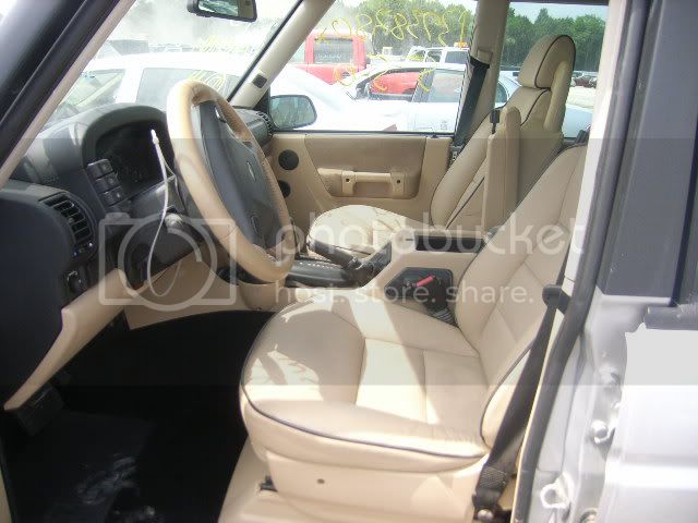

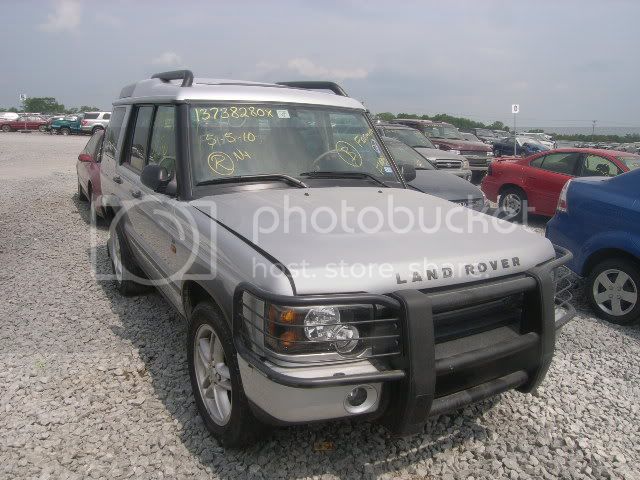

Having already done three engine overhauls and all types of repairs with other Disco's - I recently bought a TN flood damaged 2004 Disco at an insurance auction. Thought it would a nice present for my daughter in college based on what I can afford. Call me crazy, but it has low 20's original miles, no dings or dents, pretty much showroom condition except for electrical water damage so far. I'm trying to get a hold of the insurance adjuster or former owner to find out how bad water exposure was. Right now, I'm on an information gathering trek before starting to repair. Your experience and input it is so much greatly appreciated.
Here's what I have encountered at the surface:
Dashboard instrument panel does light up.
Radio, p/ windows, p/ locks, p/ seats, sunroof do not function. Doors cannot be opened from inside or out, only driver's side.
A/C blower does turn on and a/c panel lights up.
Car will not start, nor do you hear starter motor cranking.
Headlights work. No turn signals or emergency flashers though.
No water inside engine, very clean oil. So it looks like engine may not have been running when flood occurred.
Water in air filter. I'll probably have to clean out injectors just in case.
It does look like water level inside car when up to fuse panel under steering wheel.
I'm able to get ABS codes read thru Bearmach Hawkeye scanner, but getting "data link" connection error to EMS. It may be fried.
I may be able to get computer units, SLABS, SRS, tranny control unit, radio amp, ign key s/w, door key s/w all matching from a 2003 Disco. If I do so, theoretically, there is no need for dealer programming?
I'm not much worried about engine except for MAF, O2, CPS, etc. sensors.
Once again, all input is most welcomed!
Thanks and hopefully I'll have a good end story to share.
