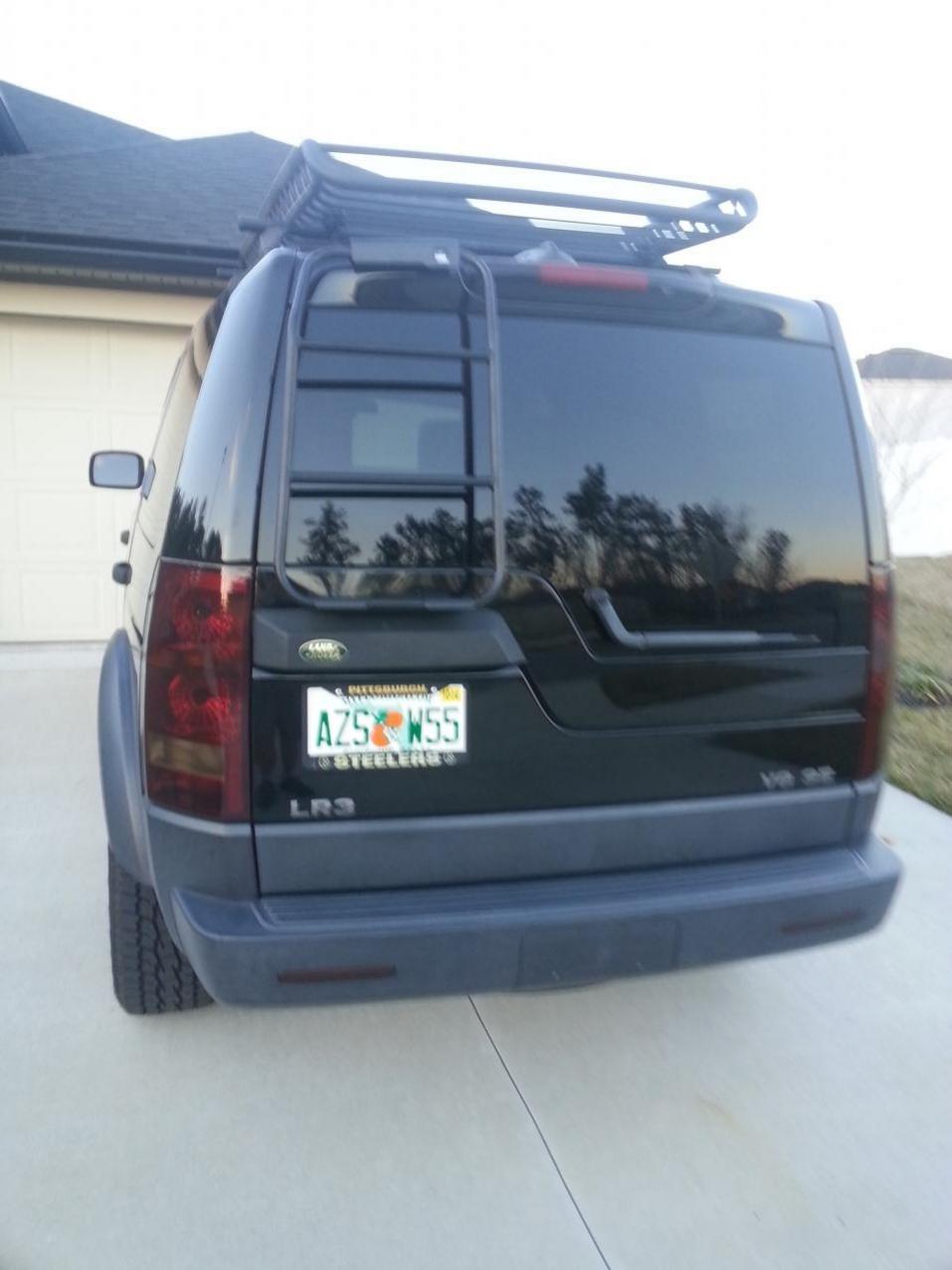

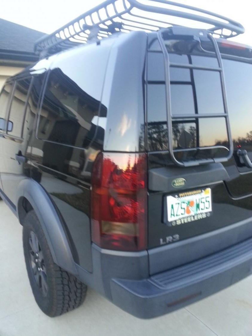

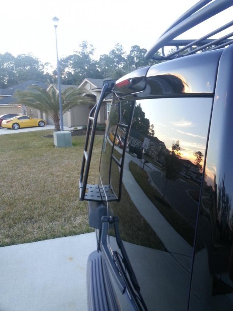

[Had some time yesterday to install the Front Runner Outfitters ladder. What I liked most about this choice in the ladder was the value, look and ease of installation. There is no drilling required and the ladder uses all existing hardware.
I did have a slight alignment issue at the top where it overhangs the hatch, but the provided bracket that installs on the hinge pulled it right where it needed to be. Total time it took was 45 minutes and the toughest part was putting the interior trim panel back on.

Ladder install instructions?
Would the ladder install instructions be a pdf that you could post? The pdf might be too big however.
I was just wondering how the ladder connected at the bottom just above the entry handle.
Do you have to remove/loosen the handle and something slips behind or what?
The ladder does look good mounted there.
Biagetti
Dec 23, 2012
201
Yes, you do have to remove the plate "light cluster" for this install. There is a flat bracket below the bottom of the step that slides over the existing holes where the light cluster bolts back through into the hatch. It fits flush with the body. The light cluster covers that bracket once you reattach the cluster.
The installation instructions are on their website if you click on the ladder then look below the picture, the installation tab is the second over. Then you can click to download.

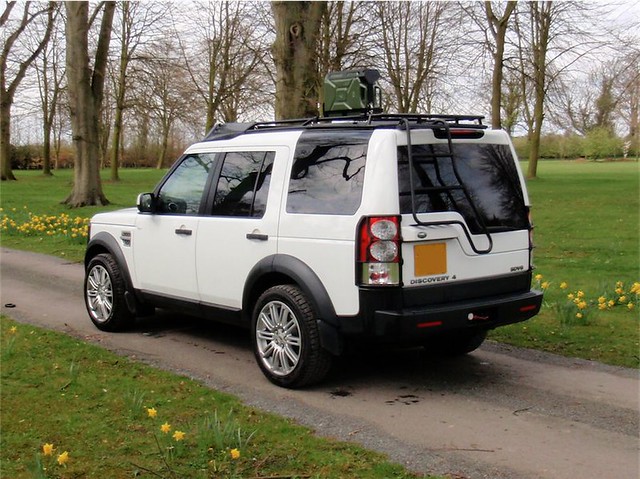

Thanks for the pics. I like the looks of the G4 one better, but not twice the price better......
morrisdl
Jan 1, 2009
717
38
There was a G4 looking ladder on amazon all winter for $200- http://goo.gl/FDQd2a
Its out of stock now, but I bet there are some more on ebay.

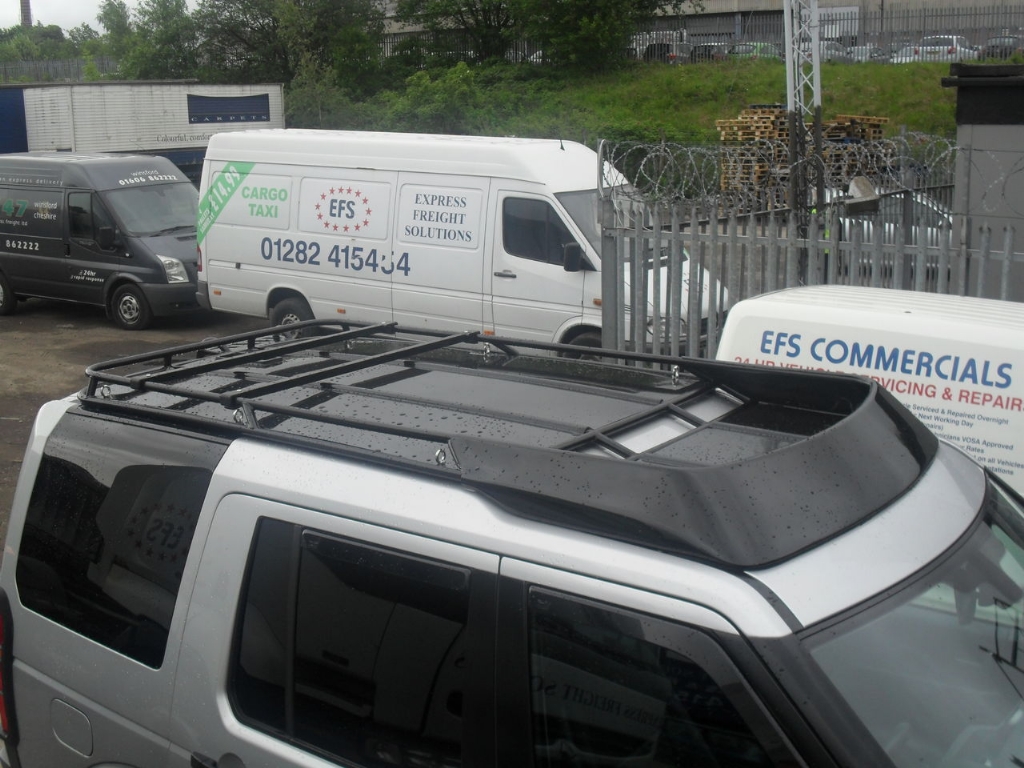

I want this ladder from Prospeed.uk, but its too stinking expensive to import:
The prospeed rack is probably the best I have ever seen too. Its so slim, you might not even notice it in the picure above. here is a better shot of it:

I've had my eye on the Frontrunner ladder for a while now. this looks like a new design too from when I viewed their site late last year... Anyway, I'm curious to know if there is anything like an adhesive strip to put between the lip at the top of the ladder and the top of the door edge to prevent any movement once you set onto the ladder? Is it a snug fit or loose? The OEM ladder required drilling 2 screws at the top to prevent movement once you step on it... Also, it that a powder coat finish?
this is taken from the install pdf:
"Hook the lip at the top of the Ladder over the Top Edge of the Rear Door through the gab between the door and the
vehicle's roof as shown. Push the Top Lip against the top
edge of the Rear Door."
