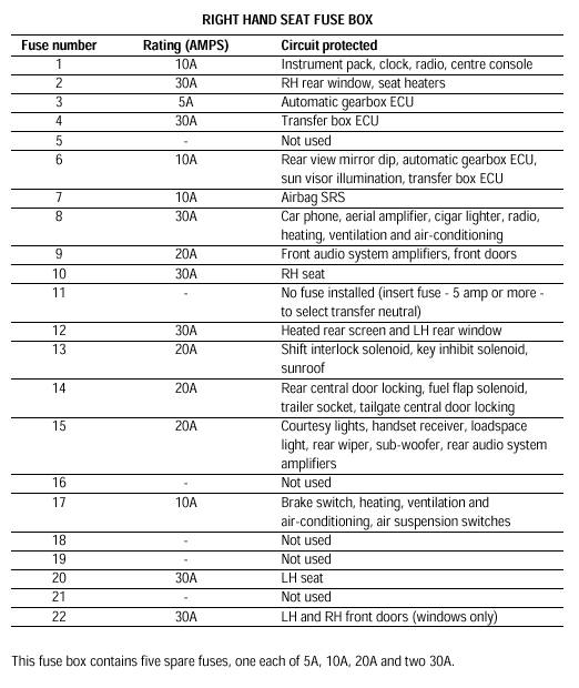

I have a 1996 Range Rover 4.0 and the driver seat stop working i thank the fuse blew. were is the fuse for driver seat, located

after you check the fuse if this isn't the issue try swapping driver and passenger switches.

I check fuses, all seem ok LF seat still not working. now I have another problem. when i put it in gear it want move. the reading on the dash is saiding the RF door is open.
Sounds like the door switch may be bad.
Okay, you have either an odd grounding problem or some corrosion an a connector.
